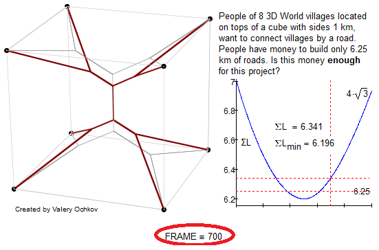

March 5, 2012
I use the Global definition operator when I make (debug) an animation:
Do we have an animation tolls in future version of Prime?
