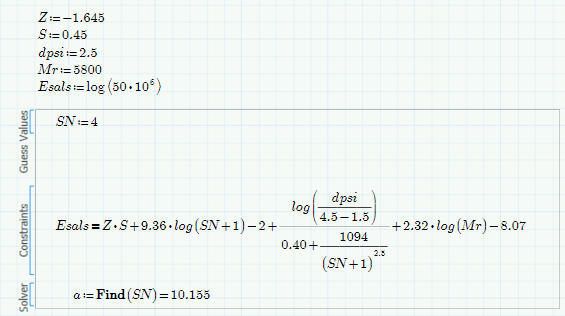

What you are asking for is a symbolical solution. As the variable SN is argument of log AND also exists outside in the term (SN+1)^2.5 you could not expect to get a closed solution. So the numerical approach shoen by Roger is the best Mathcad will be able to deliver. The steps necessary to find a numeric solution are done automatically by Mathcad. You may want to look for "solve block" in the built in help.
@Roger: I think Esals should be 50*10^6, not the logarithm of it

I imagine something like this:
