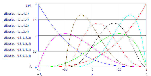

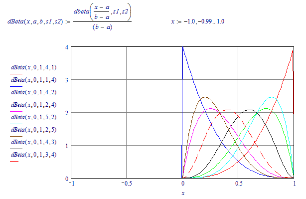

Without seeing the sheet, a distribution function that is often used to mimic many kinds of distributions is the Beta distribution.
In a more elaborate form than what Mathcad provides, it is:
Hope this helps.

The dBeta function seems to not have the asymptotal style at both ends, but I will look at it.
