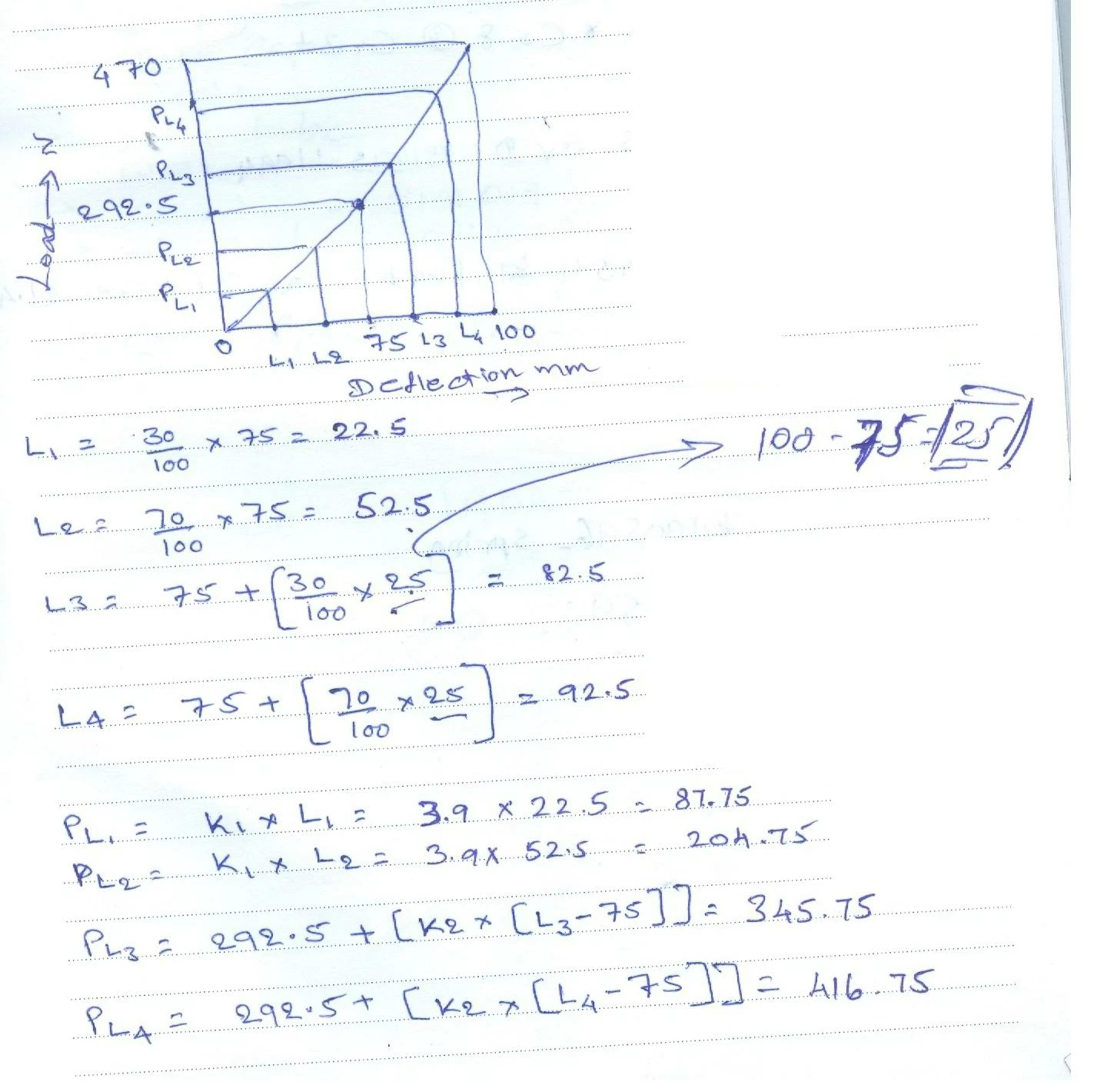

Find the attached image. How to plot such a graph in Mathcad 15?

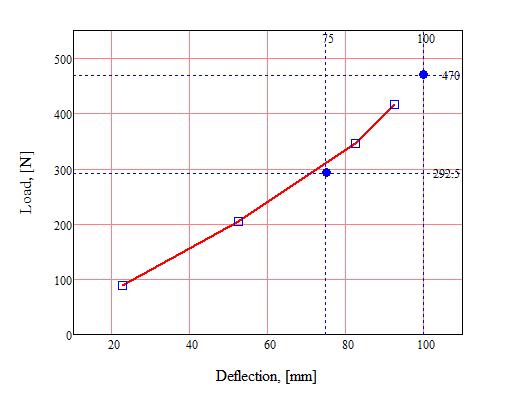

Please see attached. I have used the Lines function to create the vertical lines on the X-axis, but had to use vector's to create the lines on the Y-axis. It works, but looks untidy. I'll have a go at writing a function for the Y-axis now.

I know the graph can be plotted.
But I need similar kind of output as in image.
Dhinesh

The easiest and fastest way is as follows:

Vladimir,
Which graph option I have to use? What are the settings I have to do?
Dhinesh
July 1, 2011
The settings for plot can be changed using tab "Formatting" (right click on the plot and choose in the list "Format .."). Basic tab with which it is necessary to work it- "XY Axes", "Traces", "Labels".
P.S. I have attached to the message file for Mathcad 15.
