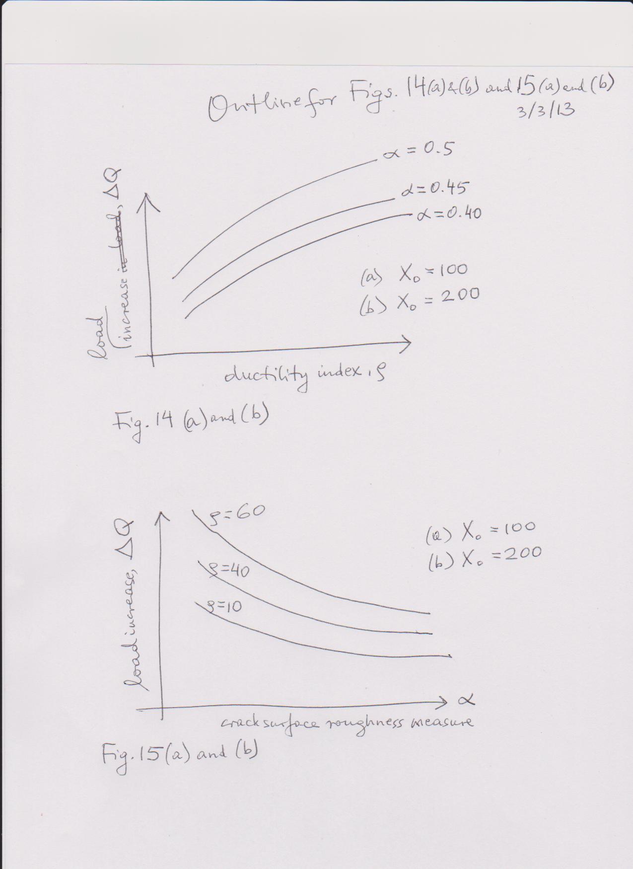

I have a worksheet (attached), with generated DeltaQ values.
I would like to plot graphs as depicted bellow:
Could anyone please help me to obtain these plots?
Please note: change rho and x0 globally at the bottom of the worksheet to get the corresponding values of DeltaQ.
Thank you,
Anousheh
Best answer by AlanStevens
The attached should help.
Alan

Anousheh1-VisitorAuthor
March 5, 2013
Hello Alan,
Thank you. Very neat program. I appreciate this.
Is it easy to do the same thing for other graph?
Anousheh
March 5, 2013
Yes. If you look carefully at the short program just above the first graph you should be able to produce something similar with alpha replacing rho.
Alan
