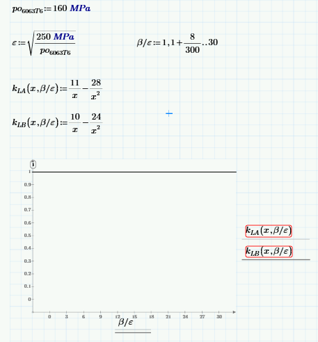

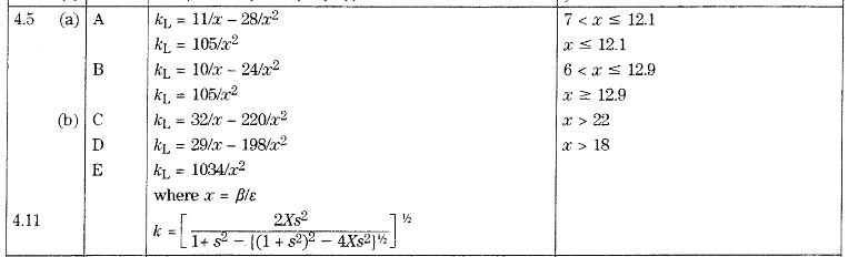

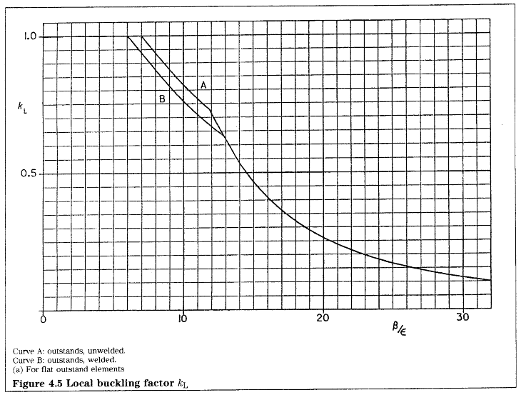

What is wrong with my variable ratio please help me.  I attached the Prime 3.1   file for you to correct my mistake   . I would like to make a graph like what I attached below. I appreciate your full support in advance  . Thank you.

You have an x as well as the ratio beta/epsilon. According to your documentation x=beta/epsilon.
Your functions should need a single parameter: x only.
Then you get:
Note that there's an erro in the definition of K.L for the case A. The second condition should read X>=12.1 instead of x<= 12.1, because that situation is (partly) covered by the first condition. And the fact that K.L should be 1 when x<7 is not specified, but graphed.
I think you can complete your work now.

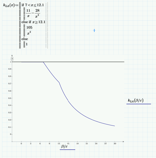

Luc  thank you I maked in prime 3.1 like this

Ah, one last thing.
Mathematically we did one thing wrong (I started, I'll take the blame): what happens in your function if x exactly equals 12.1. I think the second test should be "X>12.1".
