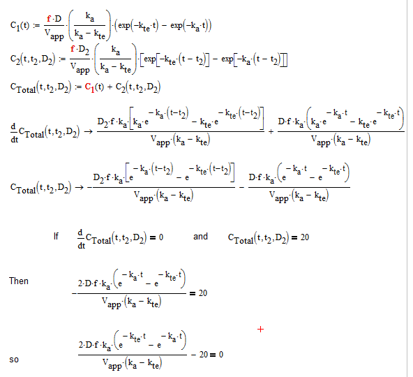

Hello, I'm having a problem with a Mathcad file - I am able to get the mathcad file to work if I separate it into two different files. However, in the same file it gives me an error about a variable being undefined. I'm not sure what's up with this. It's a first order absorption and elimination problem.
I've attached the files to show what the second part of the program is suppose to do and what it does if it works. I tried changing the variable names and references but something strange that I can't figure out is happening. I would appreciate any advice or wisdom on the matter.
Best answer by Werner_E
The reason that the Find() at the end of your gremlin sheet is failing is the superfluous "Given" at the top of your sheet after the definition of C.min. There is no closing Find, Odesolve, maximize, minerr, etc. for this given and so you can delete it and at least Find() will give you a solution.

Some correction for the plot in "7.7works" worksheet can be found in attachment.

You have a factor of 2 missing in h(D) - see below. Also, I'm not sure that your Tmax in "gremlins" matches any t in "works".
February 13, 2014
This is what was causing my problem, thank you! I must have absent mindedly typed it and forgot it was there. I was originally going to solve the first part with conditions rather a root finder, thanks!
