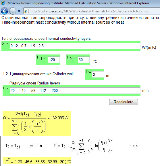

I am struggling to find where I am going wrong in the attached mathcad sheet. I have a pipeline with an internal fluid of 82.2c and then a thin coating then a 50mm thick aluminium anode is clamped around the pipeline (details on sheet). The sea temp is 5C but I keeep getting the external aluminium surface at the same temp as the sea water.
Before there is no hair left on my head where am I going wrong?

John Middleton wrote:
Hi Lou,
OK I see what you are saying but how do insert a thermal resistance between the aluminium and sea-water?
Many thanks,
John
Sorry comments is in Russian
http://twtmas.mpei.ac.ru/mas/worksheets/therm/Heat_Flow_4.mcd
but see the picture in the WebSheet
You can use ) know alpha2 (heat transfer coefficient - W/(m^2 K)

Sorry, I try use both languages on my Mathcad Serve.
It is one page from the Web Reference Book Power & Heat engineering:

Why would you expect something else? Not withstanding Richard's comments on units, you have set up the problem as a heat flow calc between two defined temperatures, t1 and t5, with three intervening thermal resistances in series. The assumptions of the calc are that the inside temp is t1 and the outer anode temp = sea temp= t5; the basis of your calc. Getting Tanode at exterior = Tsea=t5 is just validating the assumptions of your calc. Is there some other resistance you expect that is not in the model?

Hi Lou,
T5 is the sea water temp and T4 is the anode surface temp. The anode outer temp (T4) isn't assumed to be the same as the seawater temp. Does that give it a bit more clarity?

John!
Please create the picture with r1, r2... T1, T2... using a template in my attached file!
