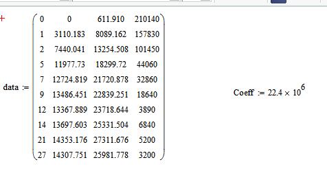

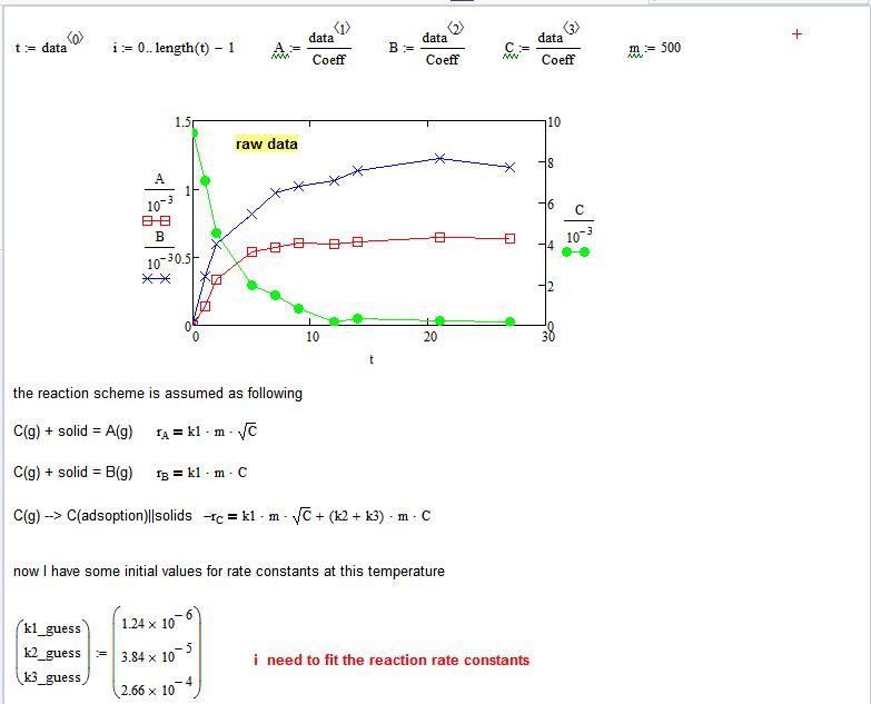

Hi, everyone
i m a greenhand on mathcad, and I want to solve some of my old problems using mathcad, which have been solved by matlab and maple .
yesterday I encountered a chemical kinetics problem, which I can easily handle through matlab nonlinear toolbox. I reviewed some similar threads in our forum, and cannot apply the method (Minerr, Minimize,etc) into my worksheet.
Maybe I need some help (see the attached mathcad14 or 11 file where I describe my question)
Best answer by AlanStevens
See attached, saved in M14/15 format as M11 doesn't find a solution.
You have k1 as the rate constant for "B". I've assumed this should be k2 - you'll need to change this if I'm wrong.
There is probably a slicker solution but it's a start!
Alan
NB I've edited this file as I realised the solution I posted earlier was wrong.
Alan
