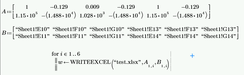

My Worksheet is like this:
I get two matrix:A and B.
A contains some numbers.B contains some strings that indicate certain blank which numbers in A should be put into.For example,A_1,3=0.009,so 0.009 should be put into Sheet1!G10(=B_1,3) in test.xlsx.
I use WRITEEXCEL function to achieve the goal but find it didn't run in for-loop.I still try other write-file functions such like WRITETEXT in for-loop and find none of them work.
Is it a bug?
Any one can help?
PS: I use Mathcad Prime 3.0 F000
PS:ORIGIN=1

Haven't started up Prime but I guess your loop is not executed because the program sequence is not evaluated or assigned. So assign the sequence to a dummy variable like dummy:=for.... or add an evaluation = after the seqeunce.
An even better and more versatile idea would be to turn the sequence into a function in A and B.

You simply define
Write(A,B):=for.....
and Write is an arbitrary name of your choice.
Later, wehn you want to use/call that function use something like
dummy:=Write(X,Y) // remark: you can use variable names A and B, but you must not
or
Write(X,Y)=
Maybe even better to make the file name a function argument and maybe even the name of the sheet (it must exist!). See attached file.
What exactly are you trying to do? You are aware that using WRITEEXCEL you may not only write one cell at at time but a whole rectangular matrix of values?
