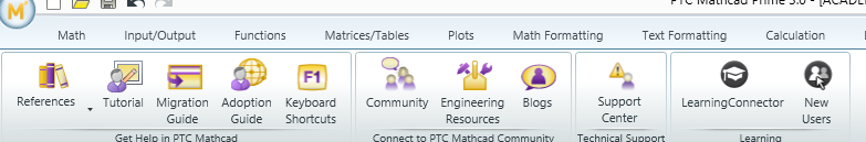

I am using PTC MathCad Prime version 3.0 datecode: 000 (2013.09.12.003/3.0.0.194). I have included the screen capture here for menu bar that when you click on things, most of them go to nowhere land i.e. ...Server Error in '/' Application.
I am just simply clicking inside the application. I should not worry about punching in the html address. The application should properly re-direct the browser (if needed) for help.  To Werner's point, I do not want to go browser each time I want to look up something.

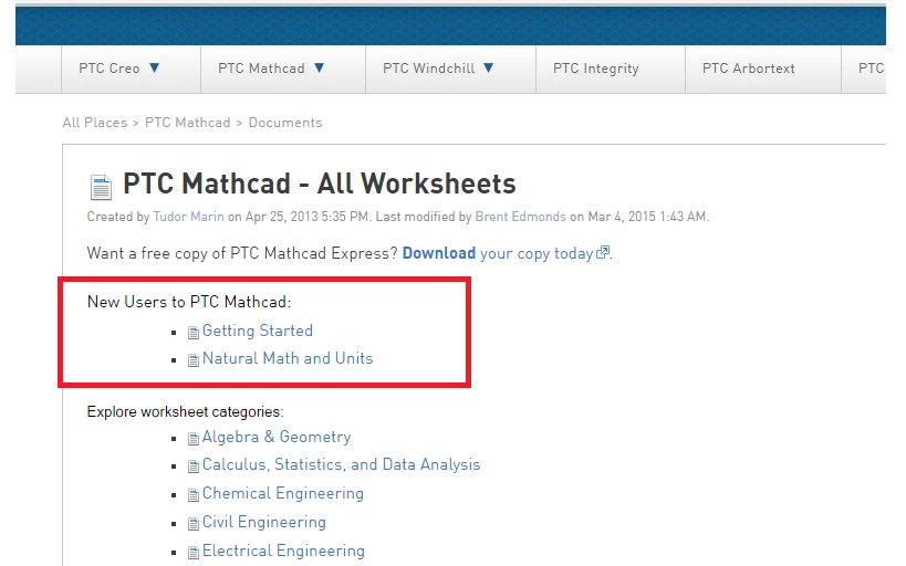

April 13, 2016
Perhaps that meant the following:
April 13, 2016

April 13, 2016
Ah! Now I see it. Its on the "Getting Started" .
I also have Prime 3.0 installed but I seldom use it (in fact I never really use it, just playing around out of curiosity) because its such a mediocre version not capable to replace Mathcad 15. At least not yet and some years from now I fear we have to live with that new UI and thats really negative prospects.
I can confirm that I experience the very same error as you had reported.
The link should be    PTC Mathcad - All Worksheets - PTC Community  ->  PTC Mathcad - All Worksheets
The reason Andy got his "not authorized" error when he tried to repair the link adress is, that "DOC" has to be written in capitals.
Really sloppy!
The same page should open when you press "Engineering Ressources".
But this page is not meant as primary help. You probably know that you have access to normal help by pressing F1 or clicking the question mark at the upper right. The help you get that way was derived mainly from the help pages of Mathcad15 but is in my opinion less helpful and much more cumbersome to use and search in. I also miss the readily available quicksheets and some of the Handbooks/E-Books.
When you press  "Adoption Guide" you get a similar error. It was meant that this document should open up
-> http://support.ptc.com/WCMS/files/154493/en/PTC_Mathcad_Prime_3.1_Migration_Adoption_Program.pdf
Thats the 3.1 version of the document, didn't bother to search for the 3.0 version.
The other buttons on the "Getting Started" tab work for me (which does not mean that they are all useful).
