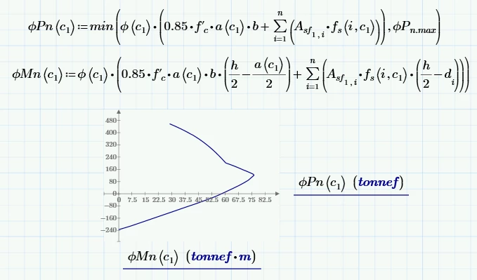

hi, I am new using mathcad prime, I have a couple of questions that I would like to help me. I'm sorry for the writing or if you do not understand what I write, my English is basic.
I was working the next function (see attached image)
I would like to add the value of ΦPn_max and 0 to the end of the result of the functions ΦPn and ΦMn respectively, so that the graph closes with the y axis

Yes, you can't do that with ranges and given the limit use of ranges thats not a real drawback.
Ranges always produce  equally spaced continuous values.

1. How do I add a value to c_1 (page 1), for example the value of 1, in the third position and how would it be done to place it at the end?
You can't do that because c_1 is a range, not a vector!
2. c_1 Is not considered a vector? What is it?
Its a range. A range is sort of an implicit loop. You should use ranges for three purposes only:
- index a vector or matrix
- in program (for loop)
- for plotting to have more control than quickplot provides
BTW, I consider it a design error that in Prime ranges and vector look exactly alike when displayed

4. Like question one, I would like to add a value to the response of a function for example to ΦMn (c_1) (page 3)
No, thats a different question 😉 In question 1 you wanted to add a value to a range, which is not possible. But now you are asking for changing the output of a function. If you want to change the output of a function, you have to change the function definition. You may do this using if..else statements. E.g. "if c_1>h .... else ...."
Keep in mind that in your sheet c_1 is a range. if you call ΦMn (c_1) the result is something which looks like a vector, but isn't (its not a range,too). You can use it only for plotting (or to display the values). If you try to access the third element by typing ΦMn (c_1)[4 it will fail. If you try to assign the outcome to a variable via x:=ΦMn (c_1) it will fail. You remember: Use ranges in three situations only!

The top of the moment/axial interaction diagram can be approximated by a straight line.
Simply plot a second line between the two end points using the same plot style as the existing curve.

Hi, terryhendicott
Thanks for answering. Regarding what you tell me it is a good idea to complete the diagram. But what I want is a way to enter a value within a variable or a function already defined for example I would like to add the value one to the variable c_1(see attached image) (I say variable and not vector because since it was defined the program does not recognize it as a vector). How can I add the value 1 either where it corresponds in increasing order and how can I place it at the end or at the beginning, is this possible? All this I do in order to generalize results to be able to write something that works for other occasions.

You can add to the top or bottom of a vector or matrix with the "stack" command.  Look it up in help if you are unsure.
You can add more columns to a vector or matrix with the "augment" command.
Is this what you are after?
