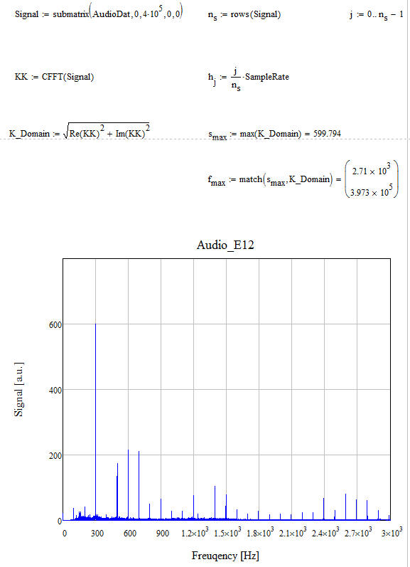

I've got a problem with an audio signal. MC either refuses to perform a FFT or to plot claiming that it either has too many data points or some error occurs. Can anybody help me on this?

I assume (from your file) that you can actually read in the file. (My version 14.0 won't even do that.)
Note that FFT?IFFT and fft/ifft require a vector with 2^m values. Try CFFT instead of FFT.

Hello Fred,
this did the trick. I figured out that MC 15 has also a problem with the amount of data points - close to 2 mio in my case. Half of that worked as there still is enough of the signal information in this subset.
However, I have a new problem now. When I try to identify the main frequency I get weird results.
#1 I do a CFFT on a subset of the signal - about 50%
#2 frequency is determined by using sample rate and number of points. This yileds a plot in the frequency domain.
#3 for determining the main frequency I find the max value via max and correlate that to the CFFT by using MATCh or LOOKUP. It should be 300 Hz, but I get 2710 Hz; sSignal.jpgee image.
Raiko
March 13, 2012
With the full data set I get 298.653. See attached.

I can't open your file since I'm limited to mathcad 11 at the moment. Here's my suggestion.
Your problem could also simply have to do with the number of data points you're trying to plot. That is restricted to some 200,000. Test that by trying to plot or display a tiny subset of your results.

March 12, 2012
Alan,
You can take the FFT of the full vector (using CFFT), you just can't plot the whole result at one time.
Looking at the signal, though, it might be interesting to slice out pieces and FFT each piece seperately.
