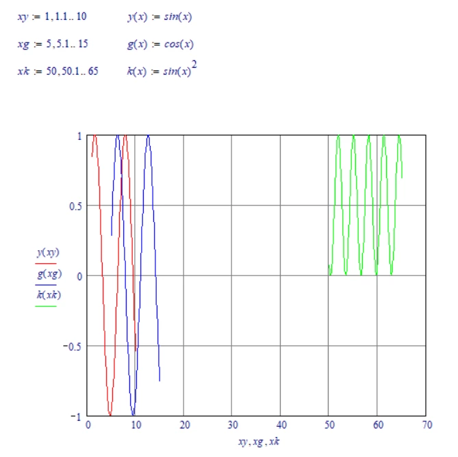

Define xy, xg and xk respectively with their appropriate ranges and then plot y(xy) versus xy, g(xg) and k(xk) versus xk in the same plot.
Mathcad does not have a Plot function.

I know how to add multiple tracers (Y axis) in a plot, but
How can I plot multiple X axis variables like xy, xg and xx in the same axis ? When I try to do so by using comma, my plot goes blank.
Could you please give me a quick sample of 2 plots of different ranges (xy and xg) like your example ?
July 16, 2019
Like this:

23-Emerald I
July 16, 2019
You've discovered why you need range variables:
