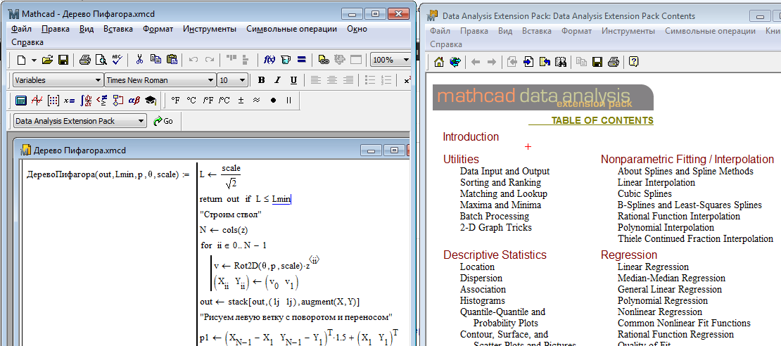

Best answer by ValeryOchkov
We can have side by side:
7 replies
April 29, 2012
April 29, 2012
Thanks.

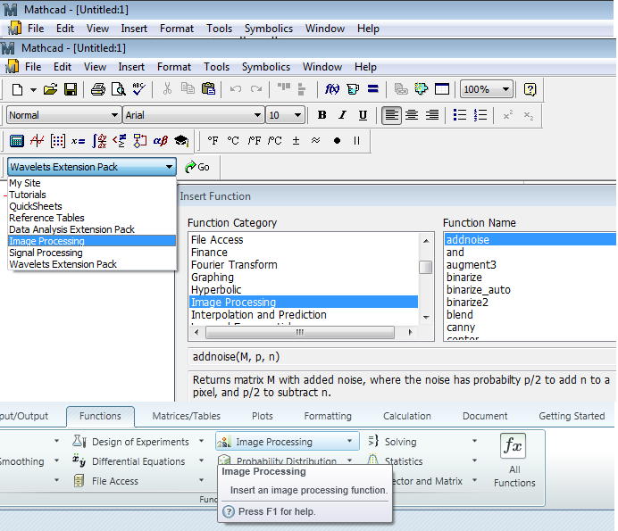

There are other useful things for me to learn from your screenshot:
1) It looks like you can insert "comments" in Mathcad programs. I had missed that. Useful.
2) The Data Analysis Pack is part of the Matchcad core program. I tought it was an add on that would have to be paid for. Could have used it a few times.
What is this Data Analysis toolbar you are showing?
April 29, 2012
I am glad to help you.
1) "comments" in Mathcad programs - see http://twt.mpei.ac.ru/ochkov/Sovet_MC/029/Tips_29_38_eng.htm#Tip_30
2) I think 4 pucks ar built-in tools in Mathcad 15 and Prime2.0:

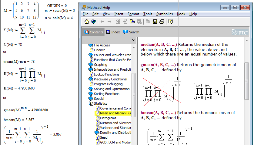

Laurent Muller wrote:
Is there an option to have the Mathcad 15 Help Window remaining on top while working on a sheet?
Thank you.
A Second method - to copy the help window as a picture (Alt+PrnSc) and paste it in Mathcad Sheet.
I have done it (see the picture below and the Mathcad sheet in attach) and... see an error in Mathcad (and Prime too) help:
