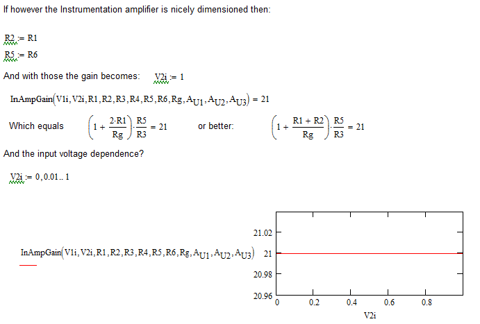

If you analyse it more thoroughly:
This should explain why the Instrumentation amplifier wasn't reacting as expected.
This gives a fixed gain, independent on input voltage.

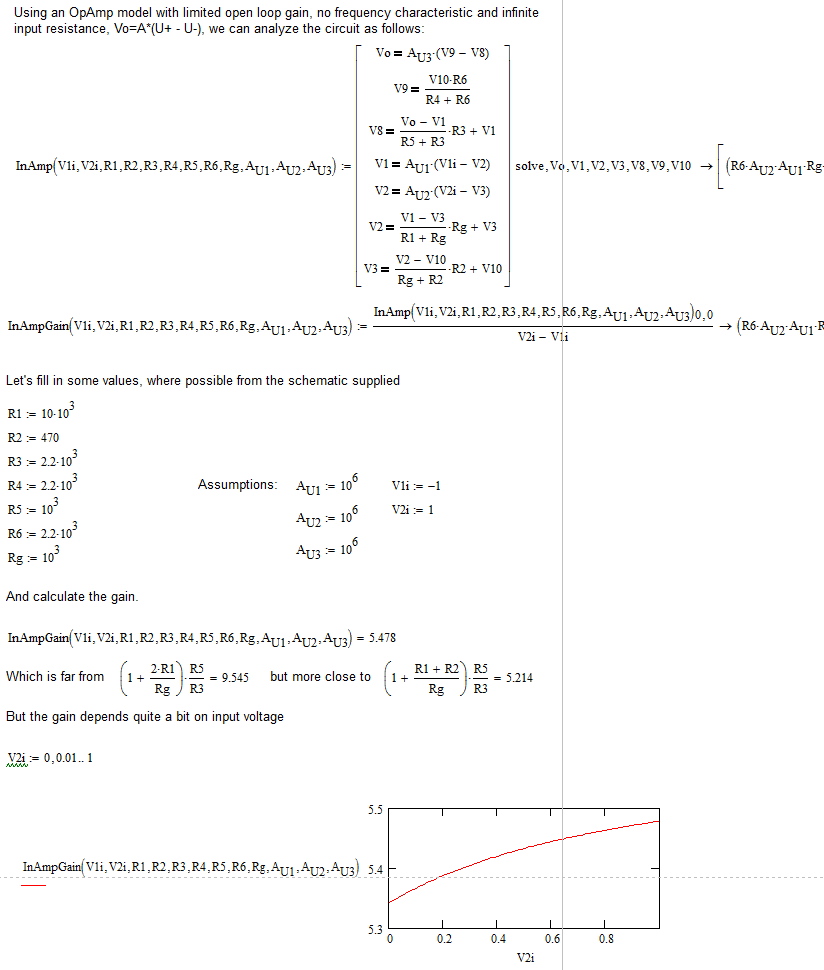

You have a very non-symmetrical instrumentation amplifier: why is R2 value different from R1's?
You are putting a lot of input on the V2 input. What is your power supply range, and does it accomodate 19 V input?

Hello LucMeekes!
What do you think about my solution?
Bye

I think your analysis is OK, but doesn't match the schematic Here's the original poster (OP) is working on.
The two feedback resistors in there (R1 and R2) are completely different in value. whereas you have them (Rf and Rf) nicely exactly the same.
Plus the OP is putting an awefull lot of voltage into one input, and I cannot see the supply voltage. In your analysis you're starting off from idealized OpAmps, (infinite supply, infinite open loop gain) which is OK if these factors don't play a significant role.  The simulation on the other hand must take account the supply voltage and (I hope) uses realistic models of the OpAmps used. I don't think it's strange that the simulation gives results that are unexpected ("But every time she tested it, she got some strange result.") if you use the setup as depicted with the gain formula { (1+2*R1/Rg)*R5/R3 } that applies to a nicely balanced instrumentation amplifier. The picture shows that that would result in a gain of 11.6... In fact if I fill in his data, I get a gain of:
But the InAmp doesn't have 2x10k for R1 and R2. It has 10k and 470, and with those values I might try:
This should explain part of the "strange result". The other part may have to do with the large input on V2, which would probably clamp one input of OpAmp U2.
