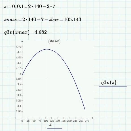

Hi Mathcad Community,
I’m working on a problem involving a box cross-section. I need to plot the shear flow distribution q(y) along the height (y). The plot should be linear in the flanges and parabolic in the webs, but my current plot is a step function and doesn’t match the expected values. Can someone help me redefine q(y), and provide the correct Mathcad function to plot a continuous shear flow distribution?
Thanks for your help!

Like this:
Maximum stress is at the neutral axis in the webs at 4.682 MPa
Mar 15, 2025 4:41 PM UTC
Your qI, qII and qIII are constant values, so you can't expect anything else but a step function.
I guess you will have to torn these variables into functions dependent on y to see a different plot.
E.g. you have to define what the q-value for example for y=110mm should be.
The way you defined is at present is that its 14.844 N/mm, the (constant) value of qII.
