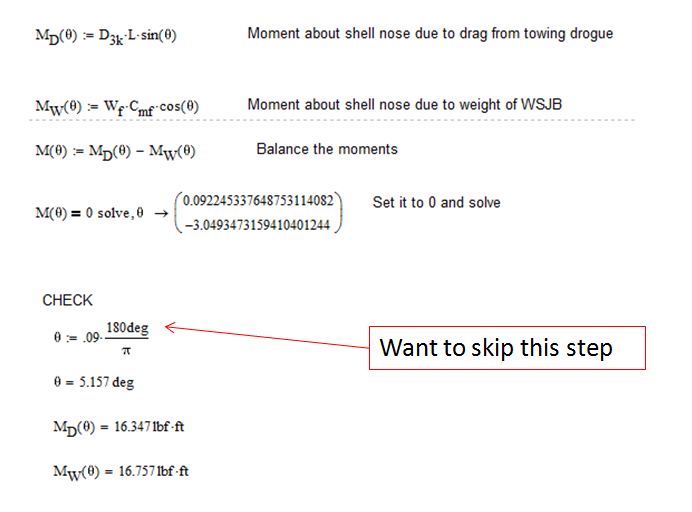

I have used the mathcad solve function to solve for theta. I would like to subsequently use the positive answer in checking the solution and resolving the forces without manually typing in the answer it returns. Anyone know how to do this? mathcad problem.JPG

You can define a numeric variable with the results of the symbolic solve (works with functions too!

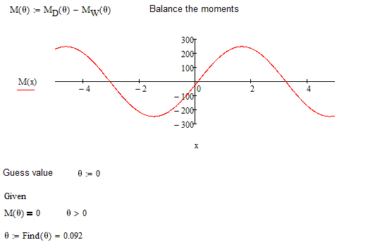

I prefer to solve such problems with the "Given" and "Find" function.
