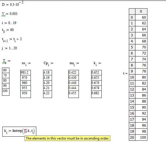

Hi everyone ı'm newone here
I couldn't find any solution please help me . Thanks
the elements in this vector must be in ascending order
Best answer by jkowalski
If we assume for D = 300000 (You make a mistake units maybe?) And this data will be within the acceptable terms and conditions. But there are data that do not fit into the established conditions and adopt it for the number zero. You can take something else and therefore there is an error.

March 2, 2013
The elements in this vector must be in increasing order.
The values in this vector must be in ascending order.
The first argument of lspline, pspline, cspline, linterp, and hist, as well as the second argument of interp, must be a vector whose elements are strictly increasing.

thanks for everything. I wondering how ı clean that red "i"
March 2, 2013
What's the error message?

This is error message.
March 2, 2013
you right they are 21 elements anyway still go on problem here worksheet

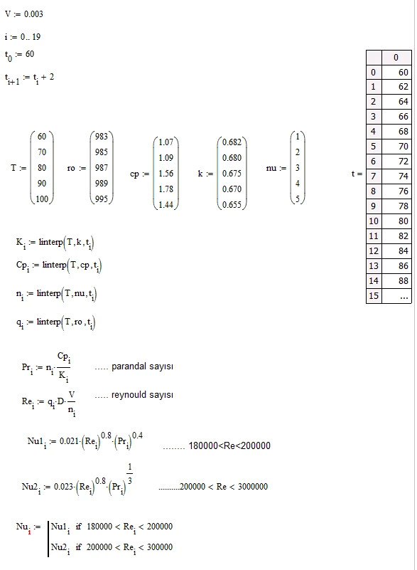

İt is over guys ı found the problem as you can see the range are so high thanks Jan and Werner
March 2, 2013
Nevertheless you should include the <= and the otherwise - just for safety reasons.
