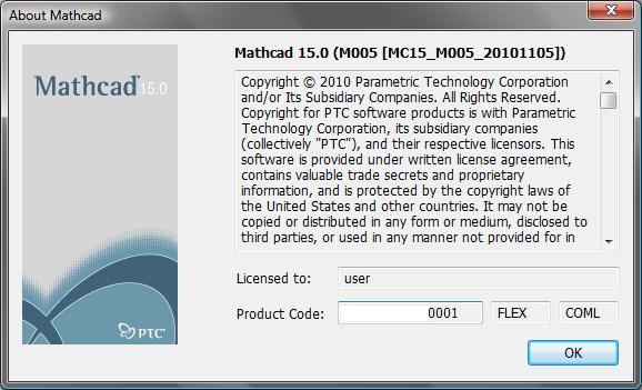

Robert, got to help => about MC => the first line in bold should state: "Mathcad 15.0 (M005 [MC15_M005_20101105])"
July 4, 2011
Hello!
If you have a license Mathcad, the window "About Mathcad" version for M005 would look like (there are no empty fields):

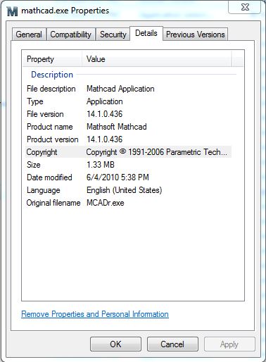

Thank you all for your help. It appears that I am still using datecode F000 as evidenced by a version number of 14.1.0.436 when looking at the mathcad.exe properties:

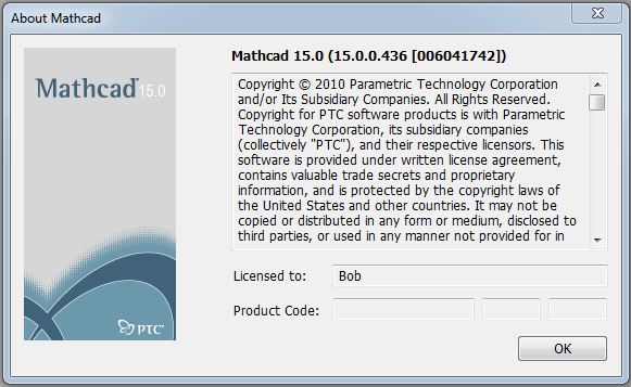

Regarding the blank license fields, here is my screen shot of the about window:
I have fully paid for a license for MathCad, with maintainence. Is there a problem with the existing installation? Will updating to M005 fix it? Or do I need to do a complete uninstall and reinstall to M005? If so what is the best procedure?
No. Ignore what the .exe properties say. I have M005 installed and the .exe proerties say 14.1.0.457. I am certain my installatin is OK.
You don't have M005 installed. If you did the "About Mathcad" screen would say M005, like Valdimir's
July 4, 2011
Richard,
Thanks for your response. I understand now that I don't have M005 installed. However, I was specifically referring now to the blank license fields. Why are they blank? Should I be concerned about it? Will the license fields be populated correctly once M005 is installed?
