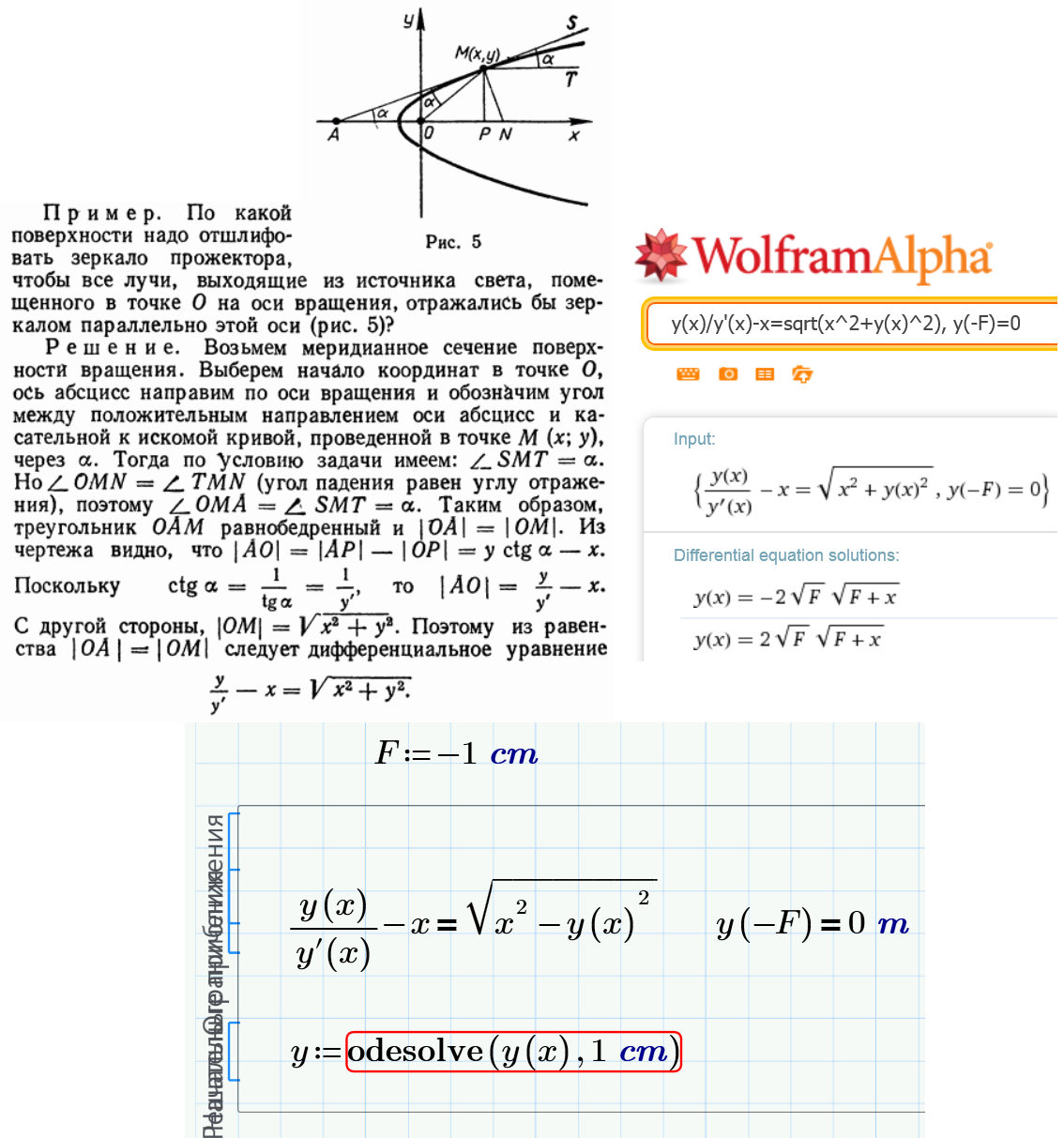

How can we get a numerical solution of one simple optic task with Prime?
See please one simple optic problem and the symbolic solution:
23-Emerald V
October 5, 2015

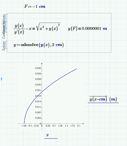

Hi Valery,
I think it should be +y(x) not -y(x) inside the root, and you should have either F=1 cm or y(F) = 0 m.  In addition, the derivative is not well-behaved when y = 0 (solve the expression for y'(x) and you'll get x-x on the bottom for y = 0) ... I've cheated a bit to get the solution, but there must be a proper way to do it!.
Stuart

October 5, 2015
Thanks, Stuart.
