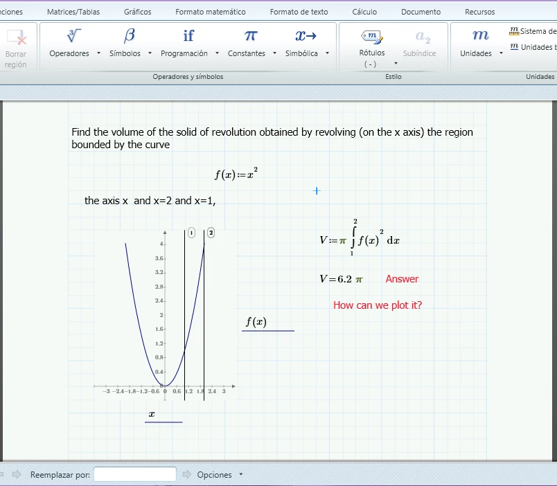

How can we plot solid of revolution in Mathcad Prime?
I finded the answer for the exercise but I don't know how plot a 3D for the solid of revolution of answer.

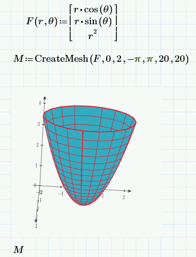

You can plot the surface using CreateMesh.
April 4, 2016
To plot a solid of revolution use the CreateMesh function.

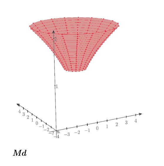

could we use g(u)*cos(v) instead of just r*cos(), and if we can how we can plot it in 3d? in Mathcad prime
July 23, 2021
Certainly. Just make sure you define the function g() and provide proper ranges for u and v.
July 23, 2021
do you mind graphing the above graph using the build in function in the matrix, with g(u)*cos(v) in Mathcad prime?

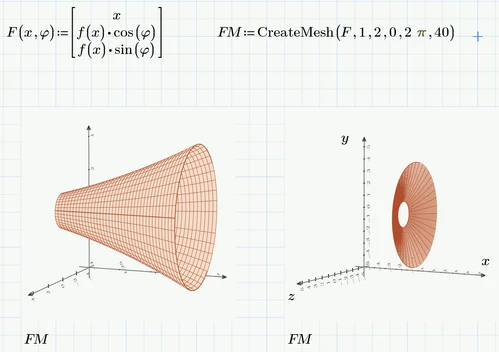

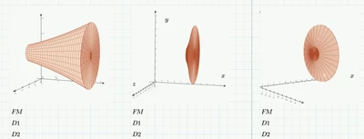

Prime cannot plot solids, just 3D-surfaces.
Here is how I would suggest to do it:
The left picture shows the result out of the box using Primes autoscaling, in the right pic I fiddled around changing the axis limits and spacing to simulate equal scales on all axis and I also added "labels". You'll have to notice that in Prime what look like the axis unfortunately are NOT the axis of the coordinate system. There seems to be no way to force those "axis" to cross at the origin - this option is only available for 2D-plots.
You may simulate a solid body by modelling and adding the two circular disks at the ends.
But if only the parabola rotates around the x-axis, no solid is created anyway.
Prime 6 sheet attached
