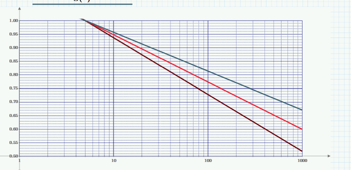

We must gave grids on a paper plot.
For Mathcad plots markers is good!

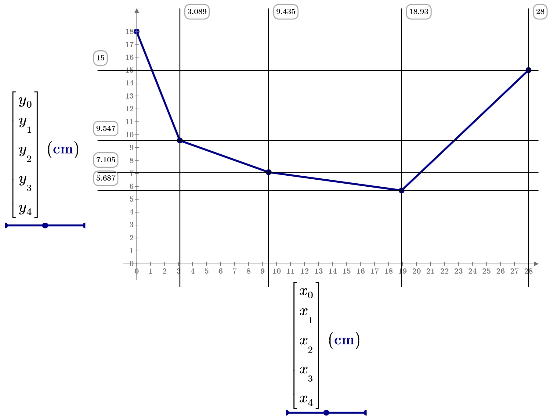

Two pictures

Yes - its ridiculous and inexcusable, but even in Version 4 Prime does not offer that basic functionality,
You have to make your own grid lines in a tedious and awkward way. See here for one possible way to do it Re: In MCD Prime 4.0 is there any way to add gridlines to plots?
