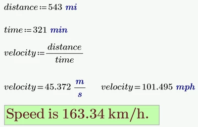

If you really want to display just the numerical result but want to hide the information about the associated variable name, you could use the Text Box (advanced controls) wit the variable as input (which you could hide. You could add any text you like, chose font size, color etc.

Here is an example of using a scripted control:
EDIT: Following Luc's suggestion I also added an Excel component to do something similar.
I don't like using embedded Excel  components but it may be a matter of personal preference.
Prime 10 sheet attached

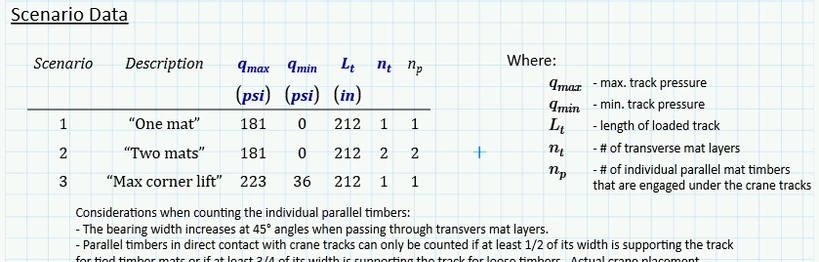

My input data uses the nicely formatted "table" feature (I wish my output looked similar):

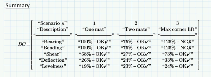

And here is my summary table after all the calculations are done.  In the summary table I only need to know the D/C values for each check and I use the OK/NG text because, for me at least, it is easier to spot the problems.  I sure wish we had coloured extended ascii characters as the Mathcad font.

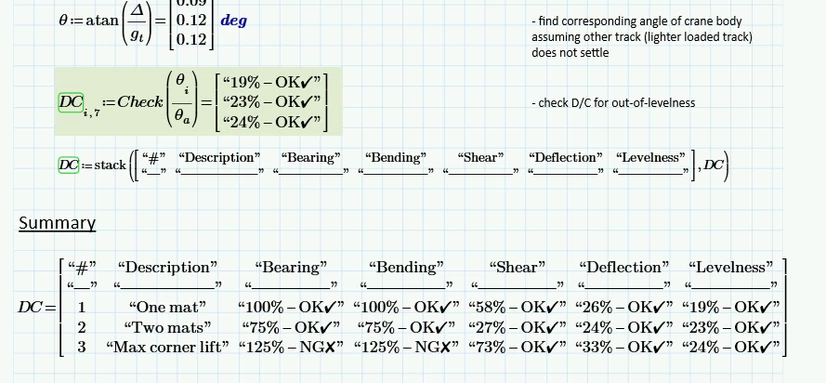

I just tried transposing the table and quite frankly I like this summary table better for this calculation sheet.  I usually do not have that many scenarios, but I can spot the problems even easier.  As you can see, the direction of the table is up to you to make the output look best:
One problem I have is if I have multiple columns of different units.  Mathcad does not allow you to choose your default units other than the base dimensions in SI, US and CGS.  In those cases, you may want to strip the units and add the units as text in your header row/column.
