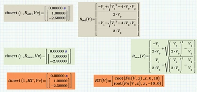

Does anyone know how to do timing tests in mathcad to check the difference in speeds in the "new" and the generally old method?
Werner_EAnswer
November 23, 2021

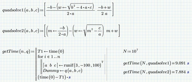

Of course its just a different way to write the old well known formula and so you should not expect much difference in execution time - it mostly depends on the implementation (and also on the implementation of, e.g. the root function etc.).
Here's my comparison:

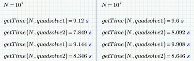

Here are a few more runs
Prime 6 worksheet attached, sorry, not working in Express

A not very exact way is to use the "time" function inside of a program which calls the solvefunctions you created multiple times.
Components for a more precise timing were posted here a long time ago, but they won't work in Prime.
Did you already turn the "new" solve method into a Mathcad function?

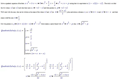

I don't think the argument is about computational speed, but more about not having to remind a formula.
You still have to calculate one square root and do some additions, subtractions, multiplications and divisions.  But to save you from reminding that formula, you now have to remember a multi step approach, and it all comes down to the same (which is good, because you wouldn't want this new approach to find different roots for the same expression).
I don't know what is more complicated.

Prime 4.0 Express file attached.  Try it!
We have a winner
23-Emerald I
November 23, 2021
Taking advantage of Stuart's efforts:
23-Emerald V
November 23, 2021
Hi Fred,
If you change that 1 as the first argument to timer1 to something like 10^3 or 10^4, you might get a better idea of the difference.  The timer functions accumulate the time taken to execute function f n times.
