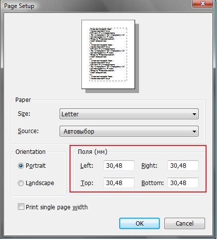

September 9, 2011
You can also change the boundaries of the worksheet (change field) "File" -> "Page Setup":
