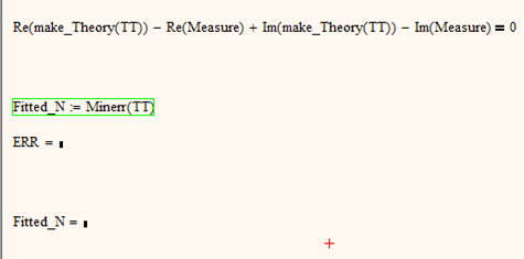

August 6, 2013
Hi:
Thanks a lot. I will read through the code in detail.
You inspired me the question whether minerr() can handle the complex number.
Now I think the answer is: No.
The code didn't work while using Q(TT):=|maks_Theory(TT)-Measure|.
By the use of Q(TT):=maks_Theory(TT)-Measure, the result came out in 30s and was the same as initial TTs (we already know).
When I use Q(TT):=Re(maks_Theory(TT))-Re(Measure), the result came out in 5 mins and gave me a different TTs set (close to my expectation).
When I use below code, the result came out also in 5 mins and gave me a different TTs set (also close to my expectation).
Therefore I think minerr() cannot handle the complex number.
Now I go back to try 25 TTs and 200 elements and check how long will it take.

August 6, 2013
I've been on an extended business trip and only just got back to looking at this again.
minerr can handle complex numbers, but it does then require complex guesses. Were your guess values complex?
The code in your image is not correct. You do not want to add the residuals for the real and imaginary parts because they could cancel. You should create a vector of residuals that contains both the real and imaginary residuals: stack(Re(make_Theory)-Re(Measure, Im(make_Theory)-Im(Measure))=0
You can use constraints with minerr, but a constraint is not treated as a hard constraint. The error in the constraint is just minimized along with the residuals. To get a hard constraint weight it very heavily. For example, if you want A to be less that B, write the constraint as (A-B)*10^15<0.
Regarding scaling issues, CTOL is an absolute number, not a fractional change in the residuals. If your residuals are very large, for example on the order of 10^12, and CTOL is the default value of 10^-3, you are asking for a relative error of 1 part in 10^15, which is on the order of numeric roundoff. It will either never converge, or it will take a very long time to do so. Make CTOL something realistic compared to the magnitude of your residuals.
