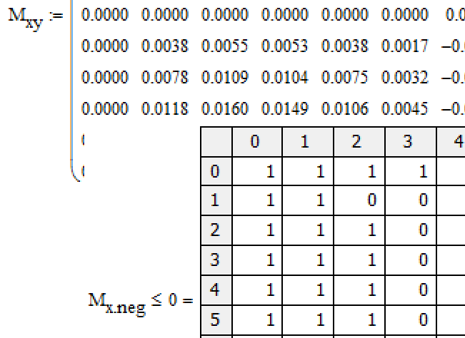

As you can see in the attached file, i have 2 matrices and i want to check a condition for each element  and to show the result depending on the condition that is fulfilled. When i try the normal "if" condition it says that it has to be a scalar.. i know I have to access at each element but i dont know how.

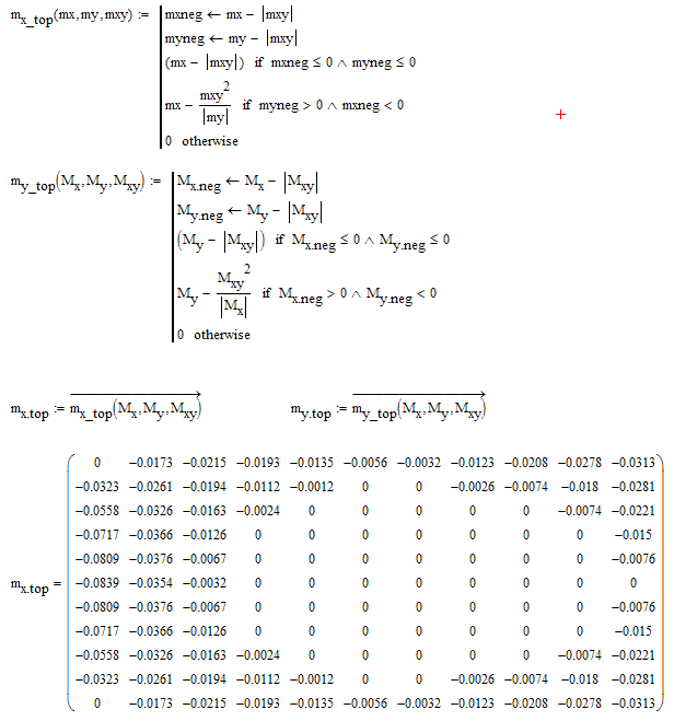

> Otherwise, the result must be 11x11
Otherwise?? I guessed the result should be a 11 x 11 matrix in any case. Some matrix elements will be 0 and some calculated based upon your two formulas.
>|M.xy| is only the absolute value of M.xy.
Thats what I suspected. And I guess the same is true for |M.x|  and |M.y|, too.
So the best solution in my opinion would be to turn the calculations into functions and write those functions as if only normal scalars are involved. The names of the formal arguments do not matter, as you can see in my solution for m.x_top().
And if this function does what it should for single scalar values, you may then call it vectorized (!!) with your matrices as arguments to get the matrix you are looking for.
See if the attached solution helps and provides the correct results you expect:
Regards
Werner

but the condition M.x.neg<0 and M.y.neg<0 must be checked in all the matrix because some elements fulfill this condition some not. better to say the condition must be M.x.neg(i,j)<0 and M.y.neg(i,j)<0, with i and j being the element row and column. so for every element, the conditions must be checked and provide the result. Otherwise, the result must be 11x11
I will consider element 1,1 for example: for M.x.neg(1,1) we have Mx(1,1)-|Mxy(1,1)| and for M.x.neg(1,) we have My(1,1)-|Mxy(1,1)|. now for this element the condition is that IF M.x.neg(1,1)<0 and M.y.neg(1,)<0 the result for element 1,1 must be  Mx(1,1)-|Mxy(1,1)|,  if both are greater than zero than te result for element 1,1 must be 0. This way all 4 conditions must be checked for each element of the matrix.
The point is that i dont need the result to be any of the given matrixes, I want a new matrix where every element fulfills the condition.
Hope i am bein more clear now
Regards
Werner
