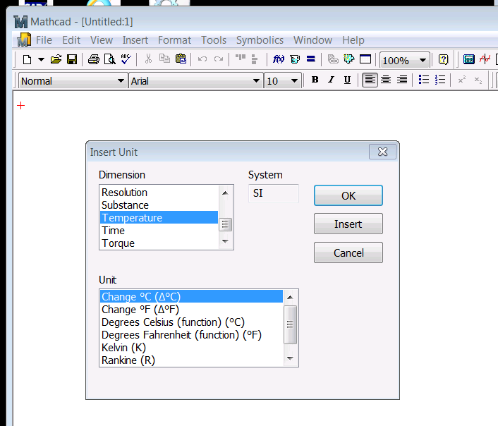

Hi.
Your issue seems very strange, when I try to insert a unit I am given the following options:
Perhaps it is something to do with the revision ...

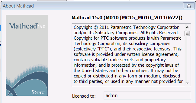

I am using version 15 M010
Does anyone know at what release PTC added the °C function?

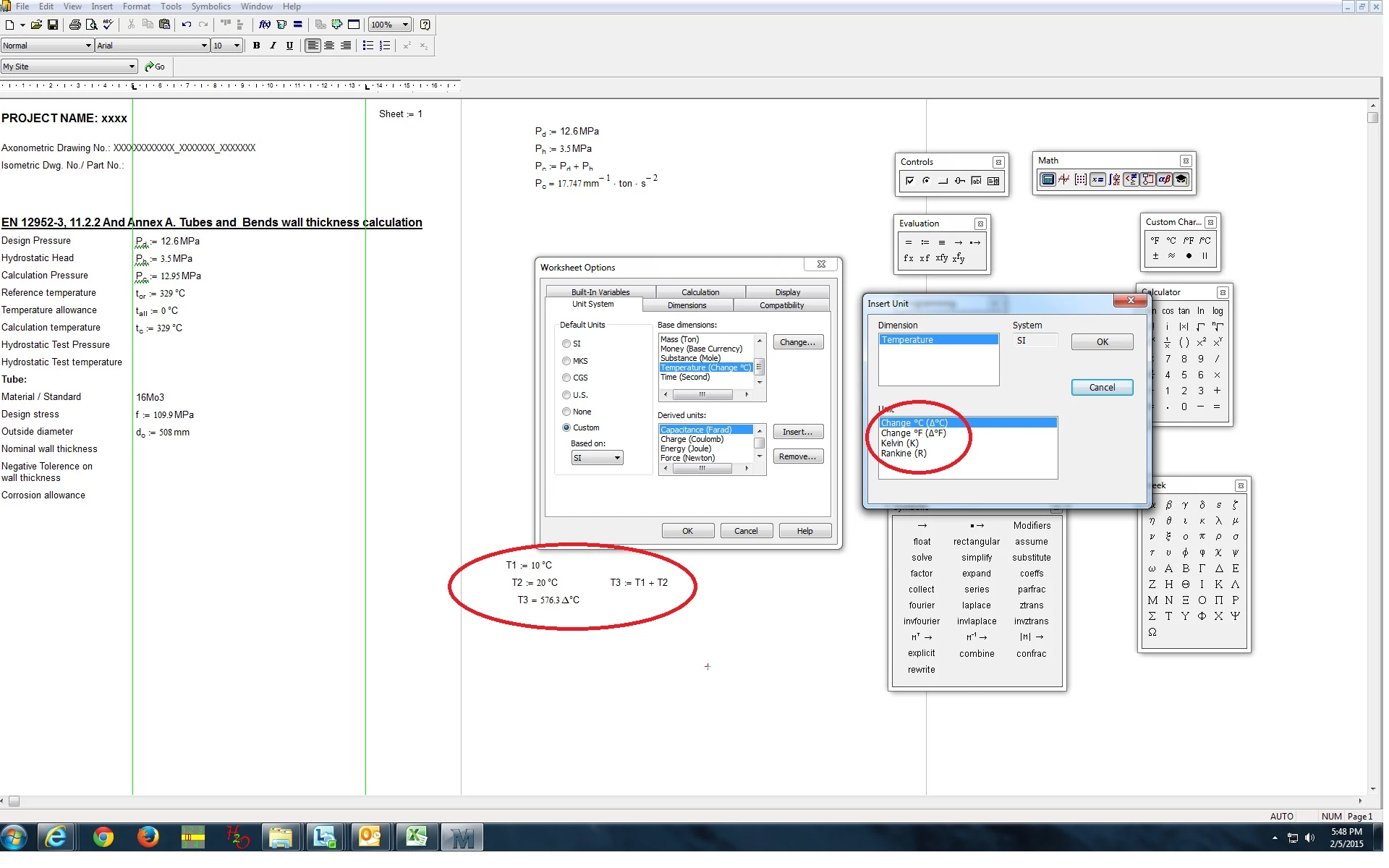

No Andy, Balaji is not trying to simply insert a temp unit but he attempted to change the default temp unit for the sheet. Here (for good reasons) only temp change delta°C is offered but not °C itself.
The problem with Celsius and Fahrenheit scales is their offset from 0.
So when you add temps in degree Celsius all summands but one have to be temp change: 1.png
Thats the reason only delta°C can be offered as replacement for Kelvin and not °C.
