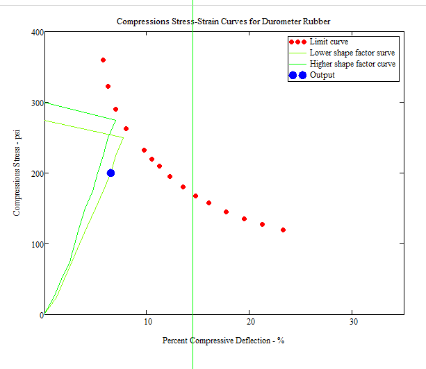

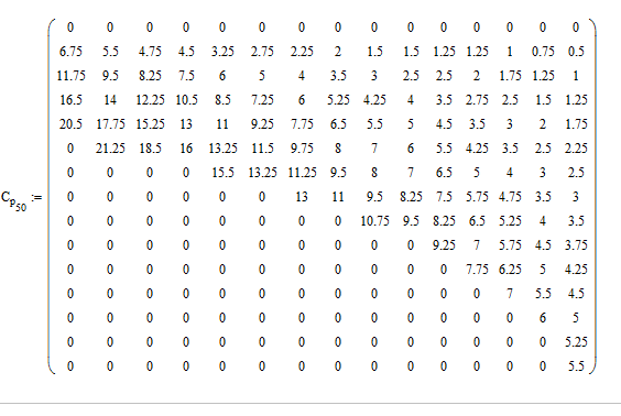

Below i have the following matrix
When I plot an "n" column against relative stress values, I get this...
Is it possible to get rid of some values in the plot in order not to get that awful line towards zero?

1) We don't see what you have plotted in the screenshot. Better attach the worksheet rather than showing just pics.
2) What do you mean by "getting rid of some values". What exactly are you trying to do? Maybe it helps replacing the zeros by NaN's.
