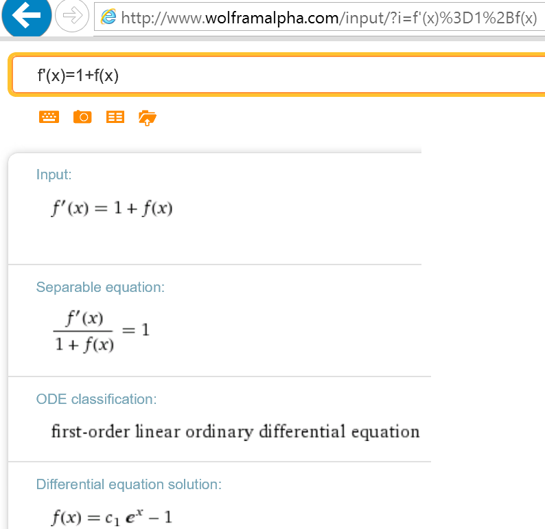

Jan 10, 2017 6:12 AM UTC
JasonC1-VisitorAuthor
Jan 10, 2017 5:24 PM UTC
LOL yes I did use W.A., but I wanted to know how to enter it into Mathcad

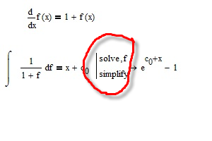

Jan 10, 2017 5:21 PM UTC
Thanks all.
I've been a heavy user for many years, but embarrassingly, I've never used the below syntax, and don't know how to type in the circled part:
Could someone nudge me in the right direction? What key stroke or mouse click? Which toolbar?
TIA!
Jan 10, 2017 7:26 PM UTC
Hi Jason
23-Emerald V

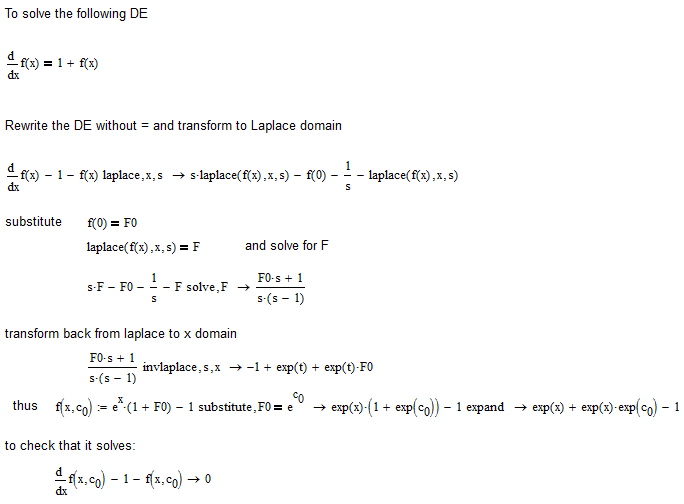

Jan 10, 2017 7:32 AM UTC
Note that the solution to the DE you provide is not THE solution but A solution to that DE.
Unfortunately Mathcad, nor Prime, provide a feature to solve for differential equations symbolically.
F.M. shows a nice way of working around that, above.
Then of course there is this method (A classical math problem: differential equations), which can be automated in Mathcad 11, but requires some hand work in later versions.
Wit your specific example:

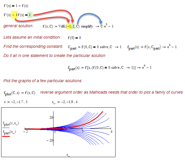

Jan 10, 2017 1:20 PM UTC
You were already told that Mathcad can't solve differential equations symbolically automatically. You have to do it manually and Mathcad helps you with the integrals.
But for the case of very simple ODEs of first order like yours, long time ago I once wrote a small routine (VdK) to solve them automatically (its for Mathcad 15 (and below)). Maybe you find it useful.
VdK assumes that the independent variable is named x. There is also a routine Vdk2 in the attached file, which can deal with arbitrary variable names. As far as I remember that was the tricky part ,-)
