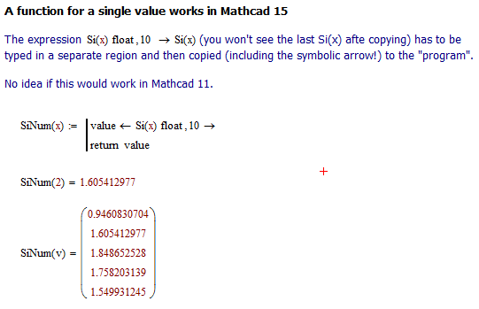

As you can see in the attached pdf the behaviour of your sheet is differently in Mathcad15 - we get an error in item 2.
Nevertheless I seem to have found a way to turn Si into a numeric function which at least works in Mathcad15, hopefully in Mathcad 11, too.
I have just played around with it and you can even make the precision (now fixed to 10) a second parameter of the function SiNum.

Werner - the paste of the full symbolic line into the program works as you suggested in mcd11. It then implements a scalar function. In mcd11, the vectorize is not implicit, as you show for Shi(v), but this is easy to resolve by modifying the program or just explicitly using vectorize.
While I have used symbolic manipulation and functions a fair amount, I have not created programs including them; they've been somewhat of a mystery to get working (as my attempts show). The help documentation wasn't helpful, as I expected, but I read through it anyway. Your hint about copying/pasting the full underlying symbolic line was key, and I expect to get my more complicated real work moving now that you pointed me in the right direction.

The copy and past thing is a real tricky one. I've learned it here (where else) when I was trying to write a program to solve a first order DE symbolically and no matter what the variable is named (should be a parameter of my function). While beeing quite tricky I succeeded but never tackled to expand to second order DEs since then.
You may even simplify SiNum by omitting the return line, BTW, making it a one-liner.
Its especially hard to see that the symbolic evaluation only affects the invokement of the Si-function an not the whole program/local assignment as you would get without copying.
