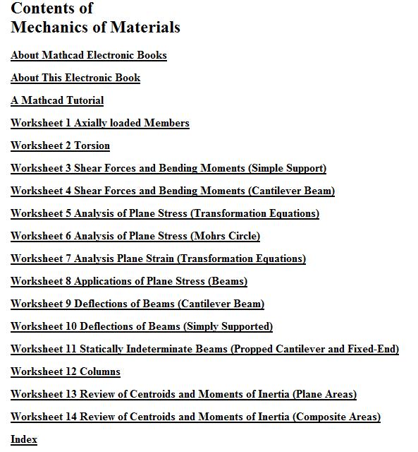

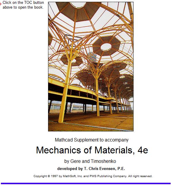

Also, for a long time, on site MathSoft it was accessible following e-book - "Mechanics of Materials, 4 edition, by Gere and Timoshenko":
