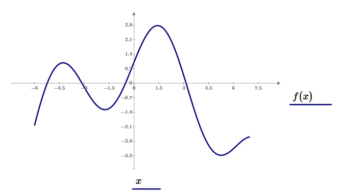

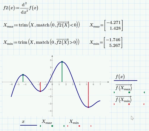

How to find Global Maximum, Global Minimum, Local Maximum and Local Minimum of a function?

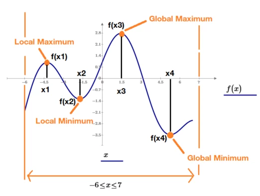

Considering the following function:
How to find:
  • Local Maximum: x1 and f(x1)
  • Local Minimum: x2 and f(x2)
  • Global Maximum: x3 and f(x3)
  • Global Minimum: x4 and f(x4)
on the interval of x:
Mathcad Prime 8 file attached.
Thank you.

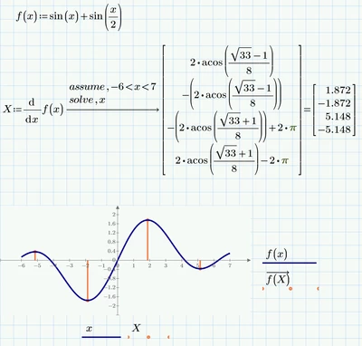

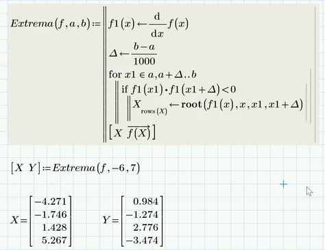

You could do as Luc suggested, but the symbolic engine (or its interface) is not capable enough to give you all needed solutions. "assume" and "fully" are ignored and just one solution is returned.
It should work that way, but only does for simpler functions where Primes symbolic has not to switch to its float mode.
EDIT: It works for simpler functions, but we should omit "fully"!

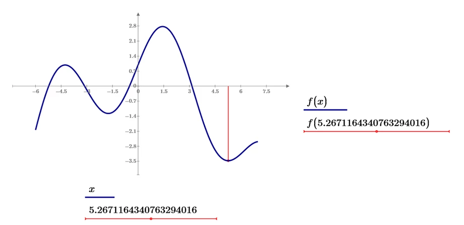

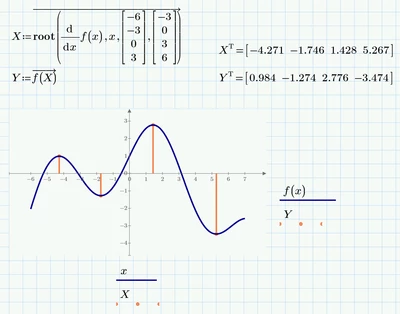

So in your case you may resort to numeric methods like the "root" function:
You may also try a utility function like the one below, but it sure won't work for all type of functions.
To distinguish between maxima and minima, the second derivative can be used:

Take the derivative of f to x, f'(x). Solve f'(x)=0. That should give you (at least) 4 roots. Calculate f(x) for each of these roots and determine from their values which one is global or local, max or min.
Cornel19-TanzaniteAuthor
So, only one root the derivative of f(x) wants to give to us (at least in Mathcad Prime (8)).

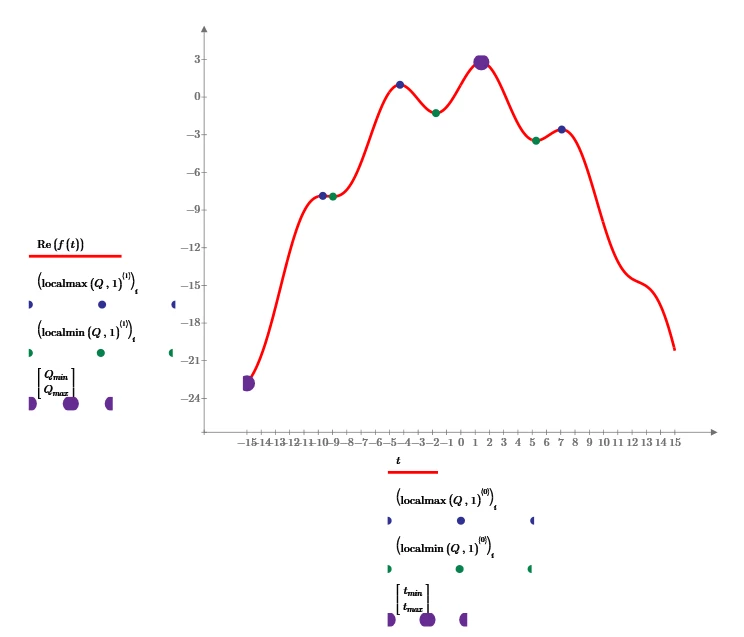

ttokoro
Using digital sampling data.
t.t.

I thought about root, but in the root it must be specified an initial guess of each individual root. And this it is something like that per guess. Now, of course, with the graph in front of our eyes the things are much easier to guess each initial guess root. I do not like pretty much this variant with guessing the solutions...
I know that in Mathcad15 there is a function by which the solution is found by giving an interval. Is it possible something like that also in Mathcad Prime?
That exactly was the reason why I quickly wrote the utility function "Extrema()". Look it up in my answer above. You specify the function and the interval and it returns the extrema. Its a function which sure would require some additional work to deal with the situation when one of the x-values used by chance IS exactly an extreme position or to deal with discontinuities, etc. But the function provided could be a starting point for your own attempts.

Maybe you confuse it with "localmin()" and "localmax()". These functions are still available in Prime, too, but they don't work for functions but rather only for sampled data vectors, as ttokoro already has shown, and they also have their own numeric limitations.
