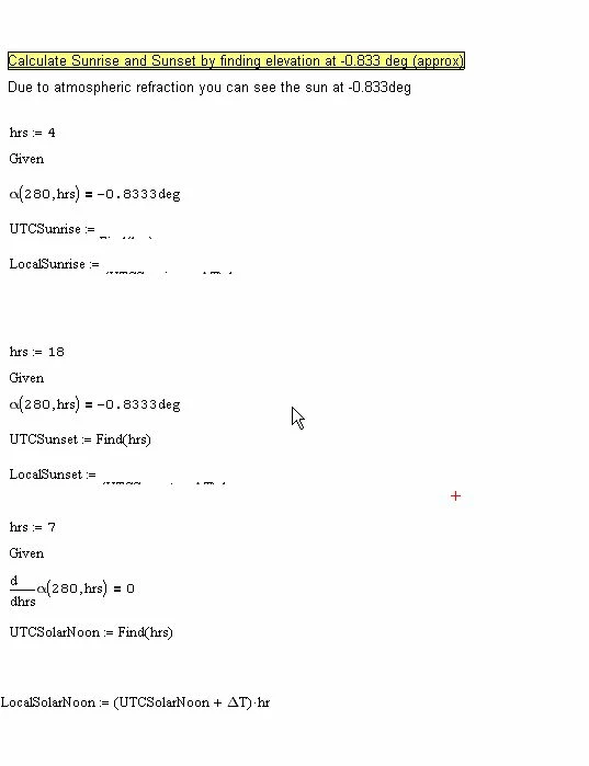

My elevation function depends of day of year (d) and decimal hours of the day(hrs)
I want to find Solar Noon the point of highest elevation angle.
I have done it for just one day of the year. But i want it to be able to calculate solar noon for any day of the year. I want it to be a variable of d as well
Attaching the image for help
Thank you in advance you guys have really helped a lot in there.
Best answer by f.kohlhepp
You've been yelled at for not posting the sheet; we're all lazy and hate typing.
In the image you posted there's a solve block. Above the given (under the X in the image) you define a guess variable, and the condition in the solve block has an argument with two parameters, "Today" and "hrs." I'm assuming from the output of the solve block that hrs is the guess variable. Rewrite the "Find" statement to be:
LocalSolarNoon(Today):=Find(hrs)
Now your solve block is a function. When you write "LocalSolarNoon(xxx) =" it will compute the solve block for watever value you've put in for xxx.

Posting the actual sheet would be much more useful if you really want help. Not that many people have the patience to re-type portions of a sheet, with unknown numbers of missing parameters.
But, in your particular case, your assignment of UTCSolarNoon to the find(hrs) should be made into a function ala UTCSolarNoon(day):=find(hrs). You then create a vector of days of the year and feed it to the function, and get back a vector solar noons.

October 7, 2010
then you are doing the work for me.
I guess you guys don't mind that. so here is the worksheet. scroll 3/4 way down till you reach the yellow box. I have explained what i want to do
Thanks in advance.
October 7, 2010
October 7, 2010
thats it.
it works.
I guess i over complicated the problem myself.
