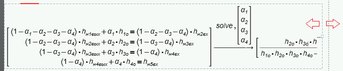

March 9, 2014
We can move the right margin in Mathcad Prime:

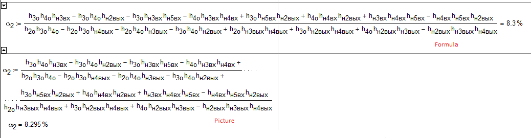

March 9, 2014
Some times I do so - a furmula in the collapsed area, a picture for the view:
