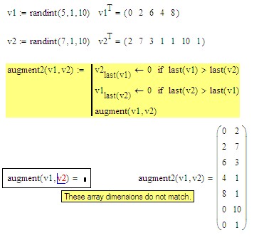

how can i combine the vectors of different array size to a single matrix.. I tried augmented matrix but it will only for same array size.
23-Emerald V
November 27, 2012
What exactly are you trying to do? There are several ways round this problem; one is to pad the end of each vector with zeros and then augment them, another is to write a short program that will augment them.
