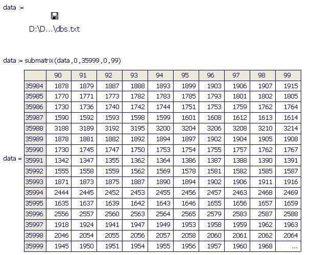

The Excel sheet you posted basically crashed my computer when I tried to read it into Mathcad. I converted the data to a *.txt file and got an error message stating "Out of memory".
If I use the Submatrix I can read in the data though.
Mike
