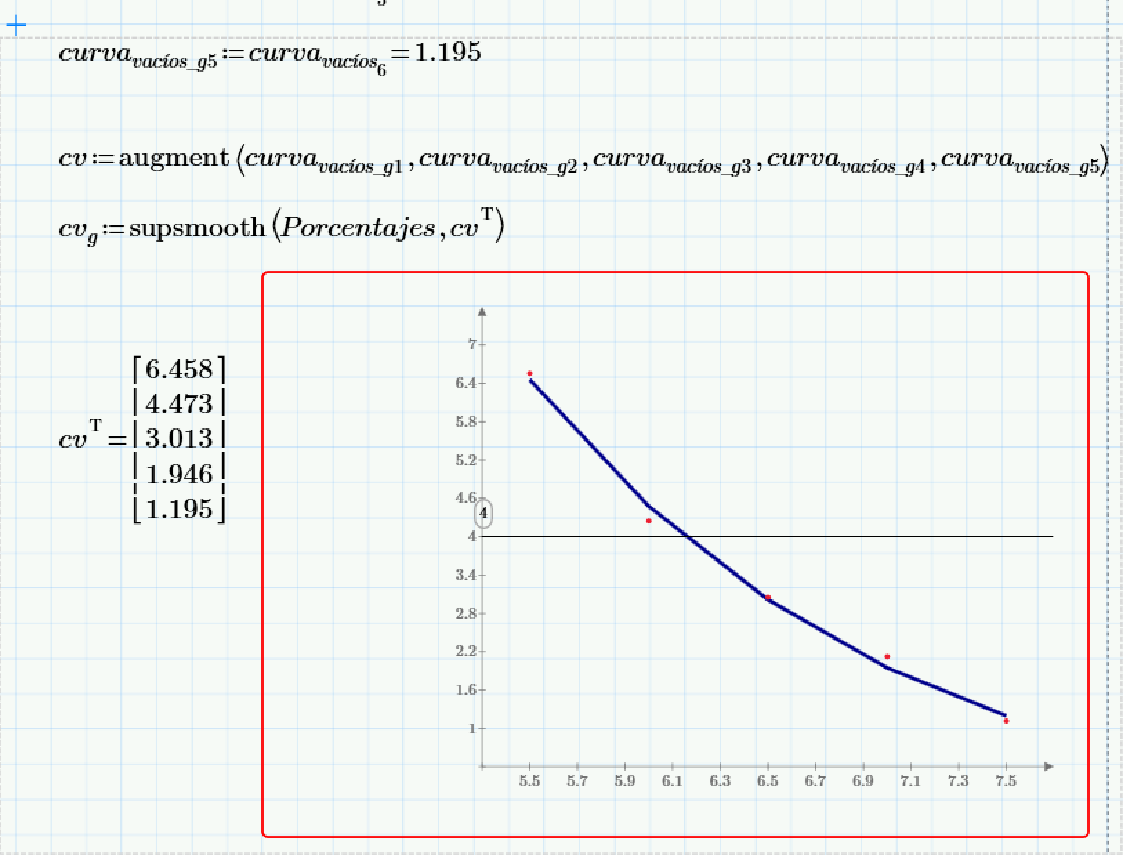

I have one big trouble, i'm making a Marshall Hot mix asphalt sheet, and in the end, i need to do some plots of the results, like (Porcentajes, Vacíos) and intercept the result in 4% and the result intercept in the other variables like VAM, Densidad, Flujo, etc.
In excel you make a tendence line with a ecuation, and i love mathcad and i need to prove to other team mates that work with Mathcad i better than excel.
Can you help me?
https://www.dropbox.com/s/q0q7l9i12eo22ez/Dise%C3%B1o%20de%20mezcla%20asf%C3%A1ltica%20EP-EMPROVIAL.mcdx?dl=0
