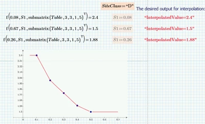

Anyway, I guess what you need can still be done with linterp, it just requires an addition to the table at both sides you add a column with repeating values. See attached.

The solution that @LucMeekes has provided works perfect, BUT, I do not want to extrapolate beyond the boundaries. Just stick to the minimum or the maximum if the interpolated value goes beyond the limits. Otherwise works fantastic!
The solution that @Fred_Kohlhepp has provided works perfect for not performing the extrapolation, but works only the SiteClass "B" and does not change automatically if I change the class to "D" for instance.
Looks like the row position is "hard coded" but I need it more dynamic to perform the lookup by changing the SiteClass to any other letter in the list...

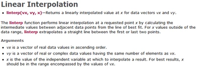

From your example there is a problem.  There is a command (linterp) that will do what you ask, EXCEPT it will not extrapolate beyond the limits of your data.  Your example has points beyond that range, and will require some thought.
(Linterp is developed to do the same thing as the Mathcad "premium feature" linterp.
April 16, 2021
Fred,
The function linterp does extrapolate as well as interpolate. From Prime (4) help:
The extrapolation doesn't produce the answers that the OP expected though:
Beg to differ!
That's why I made f(x,X,Y)
