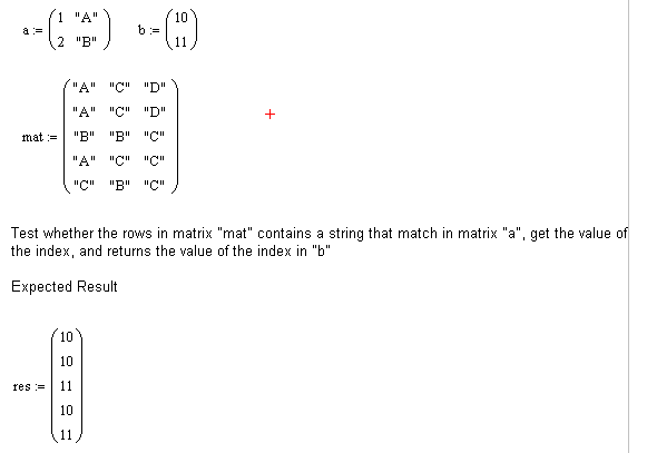

How to match the string in rows of a matrix to another matrix, get the index and return the value of the index from another matrix

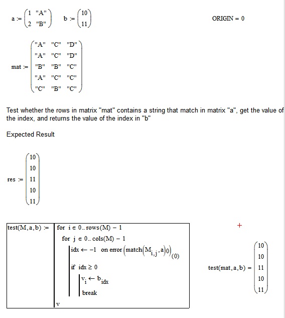

Neptali Barte wrote:
Do you mean something like the attached?
Stuart
23-Emerald V
May 17, 2012
Stuart
Bartz871-VisitorAuthor
May 17, 2012
Mr. Stuart,
Thank you so much. I really learned alot from you. I'm beginning to understand how to program in Mathcad now.
Actually, I have made my own approach to my problem above. Glad I've done it in my own way!
