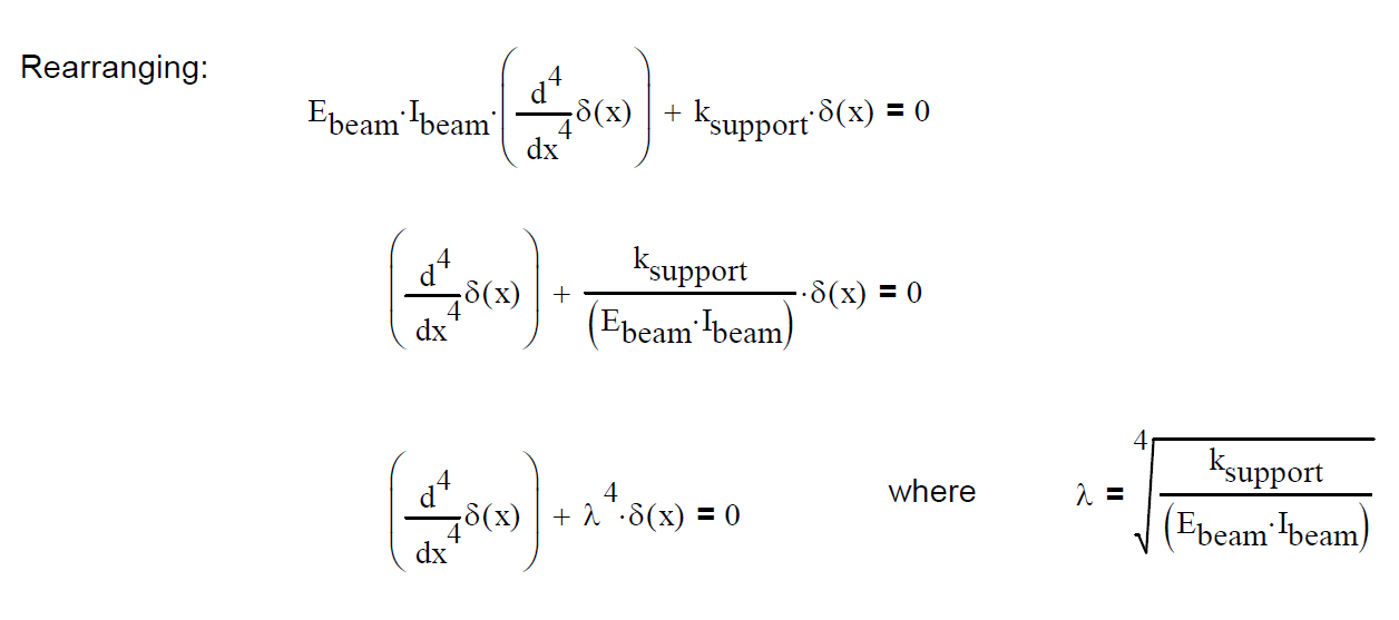

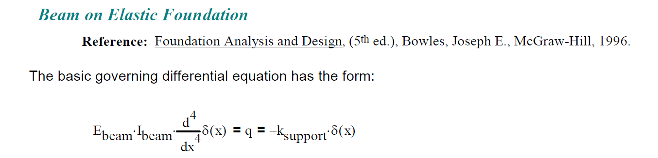

Where did you get these equations (if not "beam on elastic foundation?)  The basic beam bending equation is second order:

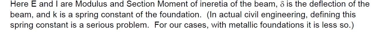

When I saw your equation, I immediately recalled an elastic foundation (railroad train tracks on the ground, or a pipe line.)  For these cases the ground pushes back--the larger the deflection the stronger the reaction.  This is q(x), but it's not constant.  For my cases q(x) = k * w(x), where k is N/mm^2.  So that is a different problem than what you're working because of the dependence on w(x).

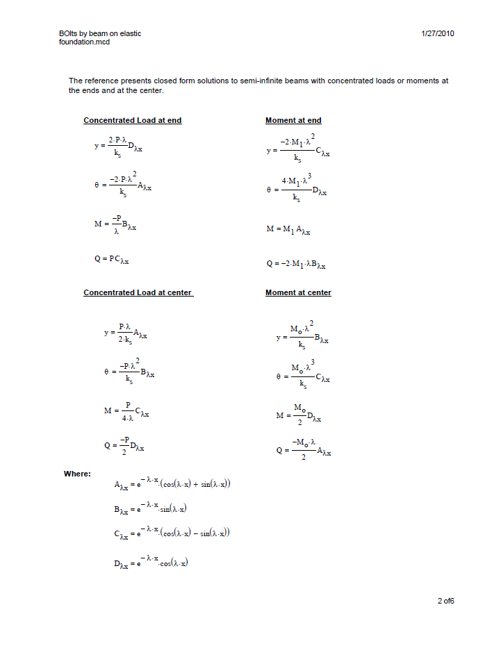

Your technique would work if units were not involved.  (We both showed that.)
If you fight your way thru with units, putting in the integration constants and using the built-in end boundary conditions to solve for them, you wind up with the same answers.  Mathcad apparently doesn't have the chops to do that directly, however.
Added a painful unit-tracking solution to the back end.  Sorry for the mess.
