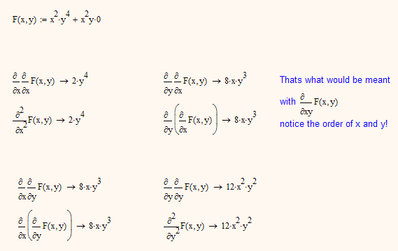

Hi
I can't partial derive the function
in dxdy instead og dx.
How do i do that ?
Thanks in advance
Best answer by Werner_E
You will need to use the differential operator twice - unfortunately that way it doesn't look like we are used to.
Werner_E25-Diamond IAnswer
June 6, 2013
