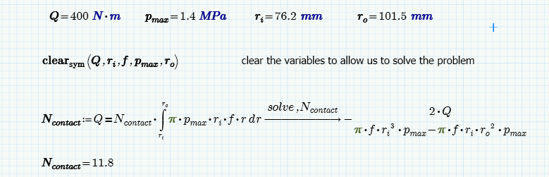

Best answer by tdevaraj
Mathcad Prime 2.0, has a clear( ) function to clear variables for re-use further down the sheet.
Also the clear.sym( ) function allows you clear said variables for use in symbolic applications whilst retaining numeric values.
see example below.
tdevaraj1-VisitorAnswer
December 14, 2012
see example below.

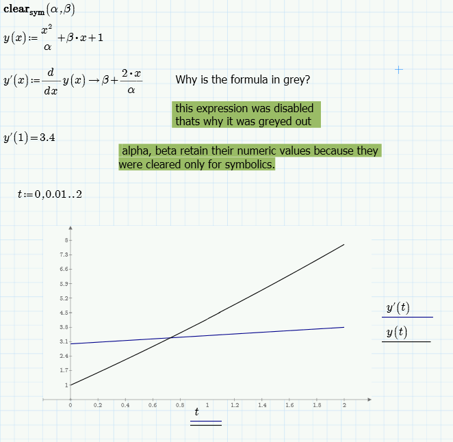

JohnDoe1-VisitorAuthor
December 14, 2012
Thank you.
Why the formula is becoming grey after using clear()? (see my attached example).
I used clear_sym() also in other projects an most subsequent equations turned grey. Is this normal?
What is the opposite to clear_sym()? (to make evaluating of variable possible again in symbolic solve).
December 14, 2012
Answer: There is no opposite...see explanation in screen shot
