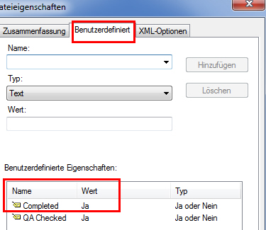

Hej,
little question, please.... i can´t find my question in the MC-help....
With the script of a textbox like this:
Sub TextBoxEvent_Exec(Inputs,Outputs)
TextBox.Text = Worksheet.Metadata.Revision
textbox.appearance=0
i can read the regular Metadata out of the FilePropertyWindow.
But what is the right expression for reading the entries in "CustomProperties" ?tt.jpg
Thanks for help.

Hej,
Thanks StuartBruff....
in my case:
textbox.text = worksheet.metadata.customitems.item(2) ' Darstellung 3. Eintrag in der "Benutzerdefinierten Dateieigenschaft"
additional help:
http://www.ptc.com/WCMS/files/129628/en/Mathcad_-_custom-controls13.pdf

R. Lampert wrote:
Hej,
Thanks for help.
TextBox.Text = worksheet.metadata.customitems.count
Outputs(0).Value = TextBox.Text
SeeBear1-VisitorAuthorAnswer

Hej,
in my case:
additional help:
