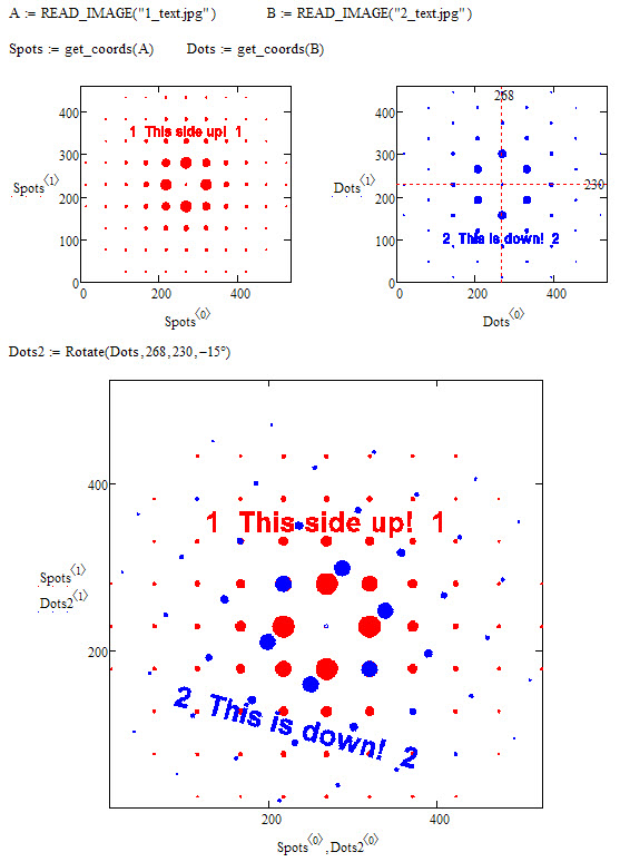

Werner_E25-Diamond IAnswer
January 30, 2014
Look if the attached would help.
The utility routine "Rotate()" works not on the image matrix but on the data structure you created and allows for an arbitrary center of rotation. I modified the routine for creation of the coordinate vectors so that the picture is showed correct in the xy-plot.
