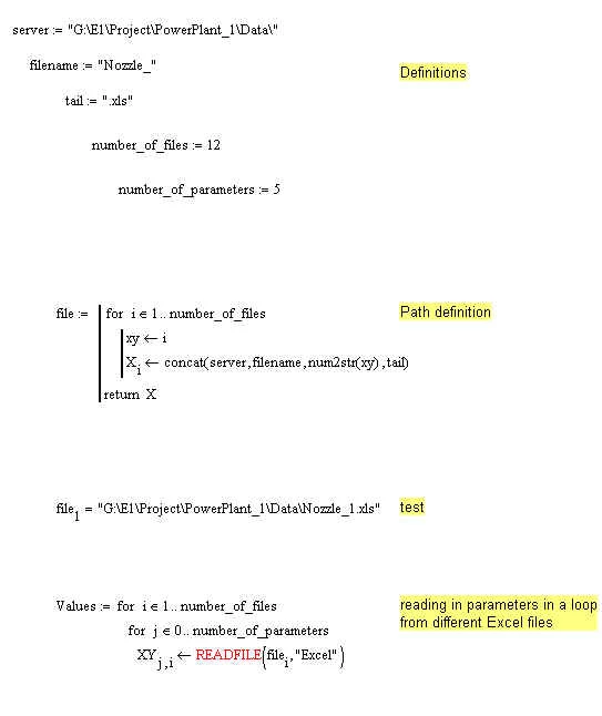

Hello Eivind,
I suggest to store the parameters in separate Excel files and to read them in with the readfile command which itself is executed within a loop.
Have a look at the attached image where some code is depicted. Maybe it is of use for you
Cheers
Raiko
October 6, 2010
Raiko Milanovic wrote:
Hello Eivind,
Cheers
Raiko
Raiko,
That would mean creating 100 Excel files wouldn't it?
He could use the attached "WRITEEXCEL" function which will write data to a specific worksheet in a single Excel file
Mike
October 6, 2010
Mike,
yes you're right. That would entail creating 100 Excel files if you have 100 Parameters.
However, if it is only one parameter that is to change than it might be easier to have an array of 100 elements from which you succesively read in the parameter value. This would be much faster than reading from an external file.
Raiko
