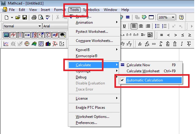

Before saving calculated document in main menu uncheck "Tools" -> "Calculate" -> "Automatic Calculation":

Thanks for your reply. However, this is not what I am looking for. What I am after is a way to not having Mathcad to 'lose' all its calculated result when it crashes or when I close it. Remove the auto calculation will just not doing any calculation (and no results) until I press F9 or Ctrl+F9.
What I woudl like to have is that the calculated data are there when I open Mathcad without needing to press F9 or activate automatic calculation.

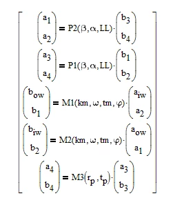

I am working on your sheet to extend it to my actual problem. However, I am stuck at this little problem of making a matrix as attached. I do not remember how it was made. I think Alan helped me doing that.
Anybod here know how to make such a 'nested' matrix? I need to put them all in one single equation for the solve box. OF course I could put them in one big matrix, but it would be nice to have it as in the attached for the reason of clarity.

Ad nested matrix: So you are still trying to use symbolics solve? You can't insert a matrix inside a matrix via Ctrl-M or the matrix creation button. Easiest way is to type the first equation somewhere on the sheet and copy and paste it to all five placeholders of the 5x1 vector. then edit the others to your needs.
