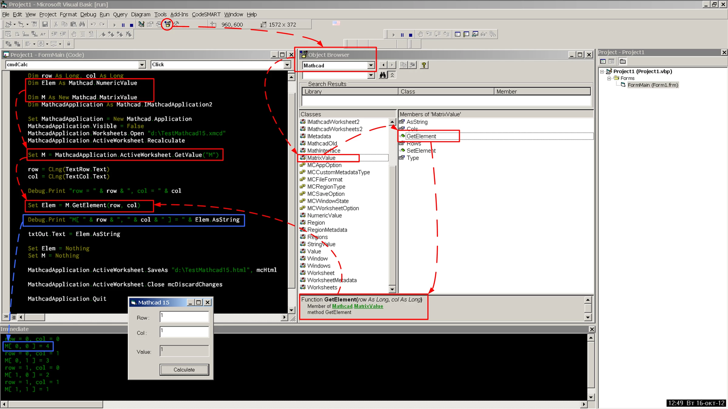

October 16, 2012
As for MC15 automation API, you can do it like this:
See the Developer's Reference, Automation Interfaces, The Mathcad Automation API, MatrixValue class:
The GetElement method retrieves the value of a specified matrix element
With OLE you can simulate this:
