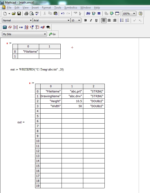

Yes i can use WRITEPRN..
But the text file format will be as shown
// Datafile written by Mathcad
// 05/12/14 10:37:22
.MATRIX 0 0 8 3
"FileName" "abc.prt" "STRING" "DrawingName" "abc.drw" "STRING" "Height" 80.56
Finally I am creating a vb.net application with good UI, which takes file path as input and writes all parameters to text file as needed. In this case i need to list all the parameters names to get its values

I am not sure from your description what you think you need. Is the problem the import in Mathcad or the export?
As far as i know there is no way to export Mathcad's variable names.
